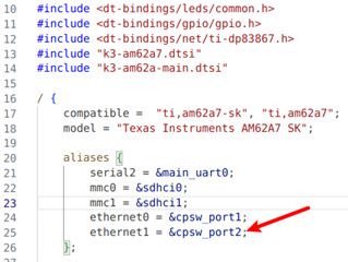

I'd like to add other eth interface on AM62A7, but there's a little bit uncorrect somewhere. Please help me check it. The configuration details in DTS as below:

k3-am62a7-sk.dts:
main_rmii2_pins_default: main-rmii2-pins-default {
        pinctrl-single,pins = <
            AM62AX_IOPAD(0x184, PIN_INPUT, 0) /* (AA21) RMII2_RXD0     */
            AM62AX_IOPAD(0x188, PIN_INPUT, 0) /* (Y20)  RMII2_RXD1     */
            AM62AX_IOPAD(0x180, PIN_INPUT, 0) /* (AA20) RMII2_REF_CLK*/
            AM62AX_IOPAD(0x168, PIN_INPUT, 0) /*(AB19) RMII2_RX_CTL */
            AM62AX_IOPAD(0x16C, PIN_INPUT, 0) /* (AA19) RMII2_TXD0   */
            AM62AX_IOPAD(0x170, PIN_INPUT, 0) /* (Y18)  RMII2_TXD1   */
            AM62AX_IOPAD(0x164, PIN_INPUT, 0) /* (Y19)  RMII2_TX_CTL */
&cpsw3g {
    status = "okay";
    pinctrl-names = "default";
    pinctrl-0 = <&main_rgmii1_pins_default>;
    pinctrl-1 = <&main_rmii2_pins_default>;
&cpsw_port1 {
    status = "okay";//"disabled";//
    phy-mode = "rgmii-rxid";
    phy-handle = <&cpsw3g_phy0>;
&cpsw_port2 {
    phy-mode = "rmii";
    phy-handle = <&cpsw3g_phy1>;
&cpsw3g_mdio {
    status = "okay";
    pinctrl-0 = <&main_mdio1_pins_default>;
    cpsw3g_phy0: ethernet-phy@0 {
        reg = <0>;
        ti,rx-internal-delay = <DP83867_RGMIIDCTL_2_00_NS>;
        ti,fifo-depth = <DP83867_PHYCR_FIFO_DEPTH_4_B_NIB>;
        ti,min-output-impedance;
    cpsw3g_phy1: ethernet-phy@3 {
        reg = <0x3>;  // first phy address
        max-speed = <0x64>;  //MII  speed is 100M

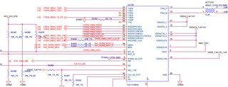

According to the Schematics, I think the phy address is 0x03:
the pin PHYAD1 and PHYAD2 are always level high, maybe the PHYAD = 0x3.

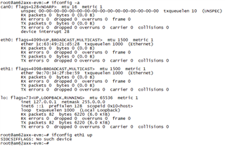

However, I found the below error when I run the modified version above:
I can't figure out the problem"SIOCSIFFLAGS: No such device". If I try to change the IP of eth1, it seems to be succeess.
So what should I do to solve this issue?
  • Here is the module of schematic:

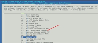

    I've also enable the TJA11XX phy on the kenerl:
    And active the TJA1101 chip set the EN pin in DTS:
            led-2 {
                label = "tja1101_enable";
                gpios = <&main_gpio1 16 GPIO_ACTIVE_HIGH>;
                default-state = "on";
    I am not able to understand what the issue is that you are working on. You are asking about PHY addressing and setting the IP address. I would like to ask some background questions so I can better  understand your system and what the issue is that you are experiencing. I am not sure which interface is having the issue so lets use eth0 for the debug process.
    I will assume this is a custom board. To clarify what is the issue, no traffic? The board cannot get an IP address?
    Please attach the following:
    • Please capture the entire boot log. I am looking to see if the PHY is identified, this helps answer the PHY address question.
    • The results of the following commands in Linux
      • ethtool -S eth0
      • ethtool eth0
