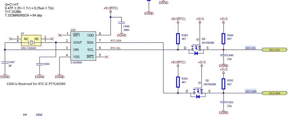

  • Hi ,
    Attached the i2c1 related schematic.
    If you need more, please let me know.
    Eric
  • Hello Eric,
    Thank you.
    I see you used a discrete level translator. Do you see that being an issue.
    Is there a failure pattern that you have observed.
    have you tried reducing the I2C speed or reducing the pull values and tested.
    Would you be able to DNI the 22 pF cap and perform some testing.
    Sreenivasa
  • Hi ,
    We tried to get a failure pattern, but it's hard for us. The fail rate is quite low.
    I have tried with 100K and 400KHz, it's not work for this.
    And we also tried to change the capacity from 22pF to 47pF, but it's still happened.
    Do you have any other suggestion?
    Eric
  • Hello Eric,
    Thank you.
    I assume you are seeing similar failures at 100K and 400K. What is the frequency you have set?
    Did you try to make the Cap DNI
    Did you try reducing the pull value?
    Do you have a level shifter IC that you can wire and do some testing to identify the issue?
    Sreenivasa

  • Hello Eric,
    Thank you.
    Could you please try the above and updated the results.
    Sreenivasa
  • Hi
    We have tried to Cap DNI and reduced the pull up register, but it still happened.
    Eric

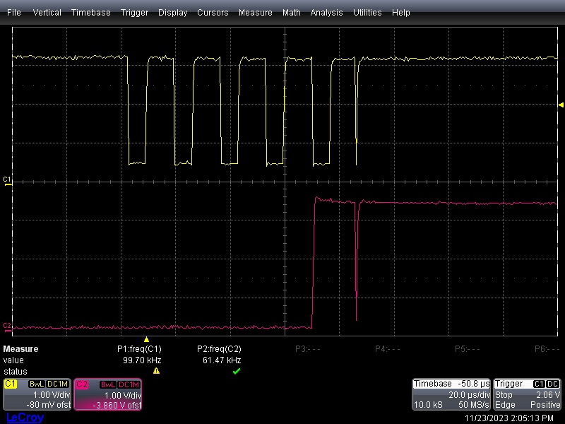

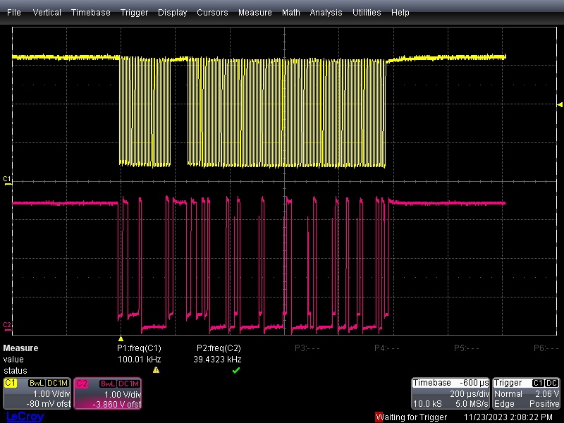

  • Hi ,
    We got the abnormal waveform.
    And below is the normal one.
    Thanks.
    Eric

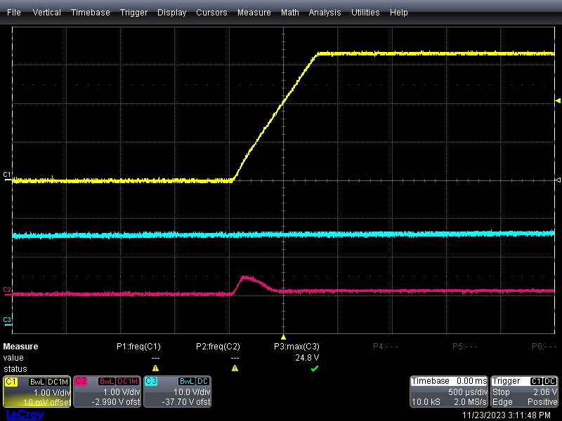

  • Hi ,
    We got another waveform and it might cause this problem.
    Suppose CLK (yellow) and DAT (red) should be pull up when power on.
    But the data pin seems not correct.
    If you can give some comment?
    Thanks.
    Eric
  • Hello Eric,
    Thank you.
    Can you isolate the RTC and check the interface level during power-up.
    When the access is working, what is the level sees after completing the read.
    is the issue happening during power up or during continuous access. After the issue is observed are you able to read the RTC rate in the next attempt.
    Sreenivasa
  • Hi ,
    We reproduce this issue by continuous power up and power off.
    It might power up about random time, maybe 1, 2, or more seconds and then power off for a short random time.
    And due to RTC have a capacity, we doubt RTC is not power off and maybe in a unknown state when CPU power off in this case.
    So, RTC chip cause data pin not pull up when CPU power on next time.
    For this, I think we need to come out a solution for this.
    Do you or Ti have any suggestion?
    Thanks.
    Eric
  • Hello Eric,
    Thank you for the inputs.
    Can you please  look for a level translator with EN controlled from the SoC side.
    Sreenivasa
  • Hello Eric,
    Pls refer below as an examples. You could choose something similar to the below:
    https://www.ti.com/lit/ds/symlink/txs0102.pdf
    Sreenivasa

  • Hello Eric,
    I am trying to understand your usecase here:
    "We reproduce this issue by continuous power up and power off.
    And due to RTC have a capacity, we doubt RTC is not power off and maybe in a unknown state when CPU power off in this case."
    Questions
    1) Is the RTC continuously powered with a separate battery supply? If yes, why are we concerned about an "unknown state"?
    2) How long is "powered off for a short random time"?
    Nick
    Let me answer your questions.
    1. Yes, there is a gold capacitor connect with RTC. Just think about a scenario, when CPU power off suddenly during accessing RTC. In such case, CPU is off but RTC does not. RTC might think there is someone tried to send message to it so it keeps at some status. Thus, if CPU reboot next time, RTC probe failed will happen.
    2.The random time might during 0.x ~3 sec.
    Eric
