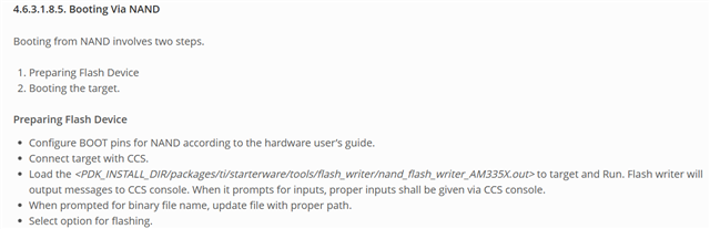

I am trying to load program to NAND flash. In the following image, it talks about: Load the <PDK_INSTALL_DIR/packages/ti/starterware/tools/flash_writer/nand_flash_writer_AM335X.out> to target and Run.
I didn't find nand_flash_writer_AM335X.out however I find NAND_Flashing_Tool.out file.
Can I use this .out file to flash image to Nand flash on am437x board? If this project cannot load image to NAND flash, is there a Nand flash writer project for am437x board?

    I have this file in my PDK folder:
    C:\ti\pdk_am335x_1_0_17\packages\ti\starterware\tools\flash_writer>dir
     Volume in drive C is Windows
     Volume Serial Number is FCCB-4263
     Directory of C:\ti\pdk_am335x_1_0_17\packages\ti\starterware\tools\flash_writer
    12/03/2020  09:44 AM    <DIR>          .
    12/03/2020  09:44 AM    <DIR>          ..
    04/20/2020  12:17 PM           277,236 nand_flash_writer_AM335x.out
    04/20/2020  12:17 PM           194,043 spi_flash_writer_AM335X.out
    12/03/2020  09:39 AM    <DIR>          src
                   2 File(s)        471,279 bytes
                   3 Dir(s)  496,025,370,624 bytes free
    Anyway, let me attach this file here.https://e2e.ti.com/cfs-file/__key/communityserver-discussions-components-files/791/nand_5F00_flash_5F00_writer_5F00_AM335x.out
