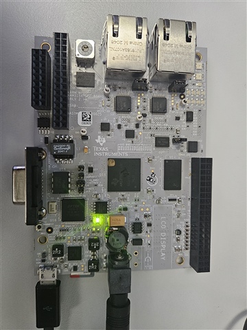

HI,
  I am trying to flash the board using SD CARD.(https://www.ti.com/tool/download/PROCESSOR-SDK-LINUX-RT-AM335X) in this link i download the image and flash in the SD CARD .
Now i inserted the SD CARD in the board and connect the putty. In putty booting is not down.  how to check weather the image is flashed are not.

  • I have a AM3359 ICE on hand, it can boot with the SDK9.0x RT Linux .wic image. log as below:
    _____ _____ _ _
    | _ |___ ___ ___ ___ | _ |___ ___ |_|___ ___| |_
    | | _| .'| . | . | | __| _| . | | | -_| _| _|
    |__|__|_| |__,|_ |___| |__| |_| |___|_| |___|___|_|
    |___| |___|
    Arago Project am335x-evm -
    Arago 2023.04 am335x-evm -
    am335x-evm login: root
    root@am335x-evm:~# uname -a
    Linux am335x-evm 6.1.46-rt13-gccf548983b #1 PREEMPT_RT Thu Oct 19 10:23:11 UTC 2023 armv7l armv7l armv7l GNU/Linux
    My board is 2.1A.
