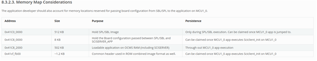

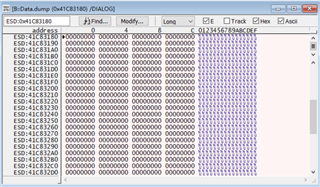

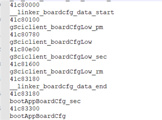

Hi:
     I'm doing some development on mcu only,The type of tda4 I use is HS,
     I have some questions,The RM,PM,Security & common board configurate infomation are different between GP and HS,The size of the GP configuration information is less than 0x2000,but HS is over 0x2000,
     As shown in the following figure, the sciserver runs at the offset address 0x2000. I used the Tda4 is HS , do I need to change the running address of the sciserver to offser 0x4000 or other ?
