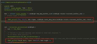

         I tred to print out all the SCI Commands but once I add the UART_Printf, the every time I power up the data , a type with TISCI_MSG_RM_IRQ_SET(0x1000) always fails and the network is unreachable.
    When I removes the UART_Printf funciton. The Program stuck at  tiipc-mgr for exactly 10minutes, and after that  it will go to the normal status.

            Toady I tried several tests to about UART_Printf
            1). Put  Uart_Printf  before Sciserver_processtask(), the SCI_server fails 100% percent.
             2). Put  Uart_Printf  after  Sciserver_processtask(), the SCI_server fails about 50% percent.
           3). Remove all the UART_Printf, so MCU1_0 will not print out data.
               It failed in 1 hour. Show one low runnable SCI command fail

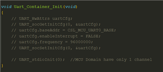

            4). Comment out Uart_Init codes, A72 stucked at Starting tiipc-mgr in half an hour, 40 seconds per test cycle.
           As this issue is occassionally occurs, it seems related to something crash together, so I stop using the UART_Printf, which may affect the codes, but not work.

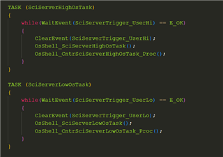

    About the details,  we run 5 CANFD and 1 IPC channel on MCU1_0.
    Here is  the task code of SciServer, note that  for high task, in OsShell_CntrSciServerHighOsTask_Proc there is just an counter counting up.
    SciServerTrigger_UserHi is an event. Similarly for low task.
    The SciServer functions is in the attatched file
    SciServerRtaos.zip
