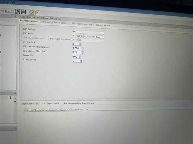

Hello TI expert,
I used the LSC module in DCC software on the AM62 platform and found that the effect was not as expected. The first image shows the effect of closing the LSC module, and the second image shows the effect of the LSC strength parameter being 100. May I ask why this situation occurs?

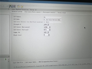

  • What I mean is that the effect of the LSC module is abnormal. You can take a closer look at the second image and I will mark its effect for you
  • Hi enrui,
    Could you please provide your LSC settings, raw, and yuv images?
    I suppose this is for a linear sensor without tone mapping.
    Also, which SDK version do you have?
  • Hi, Gang
    The following are the provided lsc settings, raw, and yuv images, and the version is SDK8.6
     zxy_2592x1944_Date_15-11-2023_Time_14-29-17 20231115 lsc origin.zip
  • Hi enrui,
    Thanks for highlighting the issue!
    It looks like an issue in the LSC driver.
    Hi ,
    Could you please test LSC on 9.0 or 9.1 to see if it works properly?
  • Hi,Gang
    Have you tested the LSC module on SDK 9.0 or 9.1 yet?

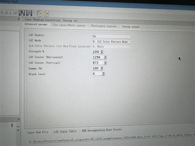

    I also want to ask a new question. Is the Lut table in the LSC XML of DCC software obtained through methods such as round (((gain 1) * 256/4), and is the gain value in the formula the ratio of the central block to different blocks? I feel that the value calculated through this formula is too small.

  • Hi enrui,
    The gain value is encoded according the gian format.
    As format "1" is for Q8+1, a gain value of 80 means 80/256 + 1 = 1.3.
  • Hi Enrui,
    I have tested the LSC module on SDK 9.0 and have confirmed the bug. We are working on a plan to resolve the issue, please allow a couple days for an update.
