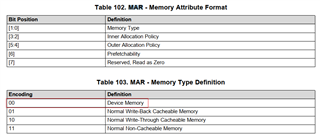

        Is the MAIR register definition in C71 MMU the same as the definition in ARMv8? The value of the Mmu_MAIR4 variable in pdk_j784s4_08_06_00_31/packages/ti/csl/arch/c7x/src/mmu.c is initialized to 0x44, which corresponds to the no cache attribute( Normal memory, Inner &Outer Non-cacheable) if parsed according to ARMv8.
       However, if you follow the MAR register analysis in the TI manual, it is the device memory(0x44 , 01000100b), which cannot correspond to the actual firmware configuration attributes.
