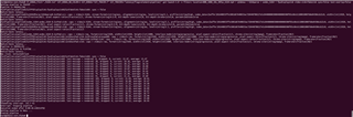

gst-launch-1.0 multifilesrc location=/home/root/$1 loop=true ! qtdemux name=demux demux. ! queue ! avdec_aac ! audioconvert ! audioresample ! alsasink demux. ! queue ! h264parse ! avdec_h264 ! videoconvert ! fpsdisplaysink video-sink=waylandsink  text-overlay=false -v 2>&1
playing a video that is on the SD Card
using the sk-LCD1 with the board
i have developed some questions that are slowing me down.
a) is this the right command to get fps information from gstreamer or is there a better way to do it?
b) playing a 1920x1080 video with all 4 cores and the GPU active (i assume as i haven't disabled it for this test) my FPS for the video hover around 22FPS. is that expected or should it be higher?
c) when i drop to 2 cores (GPU on) the FPS goes down to about 7FPS, is that expected?
d) when i disable the GPU and try to play the video no video plays at all. i get the audio but the best i ever get for video is a still image from one of the frames. the output from gstreamer FPS would make it seem like it is outputting video. do i need a different gst command to play video when the GPU is disabled?

  • Hi Michael,
    On AM62x, we don't have hardware accelerator for video encoding/decoding like in AM62A SoC.  The plugins that are being used are open-source GStreamer plugins that may not be optimized for performance, so we can't guarantee that fps shown by fpsdisplaysink with these plugins are correct due to latency/performance issues.
    I tried to run this pipeline on my setup:
    gst-launch-1.0 -v filesrc location=BBB_1080_10s_30fps_h264.mp4 ! qtdemux ! h264parse ! avdec_h264 ! waylandsink sync=false async=false and it ran fine on my setup with HDMI.
    May I know what are you trying to do with disabling GPU and using software plugins, because when you disable GPU, the openGL softpipe renderer is being used. So ultimately, you are using software decoding + software rendering, which is why you are seeing the performance issues.
    Suren

  • Michael,
    The pipelines are correct expect for queue's that you have added on your pipelines, queues increase latency.
    Gstreamer offers fpsdisplaysink to see framerate information, I would suggest instead of actual sink run the pipeline with fakesink to see if the data being received till the sink is showing the right FPS.. The FPS might drop based on the display connected to the EVM board..
    As such, using hardware accelerators would improve the processing a lot faster compared to software based plugins (Which as I mentioned earlier are not optimized for performance).
    With regards to GPU, if you disable you end up having software rendering using CPUs. I would definitely suggest you to have GPU enabled on AM62x and  perform tests with all 4 A53 cores. You can also measure performance by reducing the cores by adding the maxcpus parameter as mentioned here:
    https://dev.ti.com/tirex/explore/node?node=A__AUTBljJxXWNOgUHj.1-BaA__AM62-ACADEMY__uiYMDcq__LATEST&placeholder=true
    Hope this helps.
    Suren
