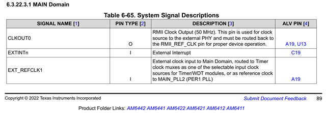

AM6442: Routing of EXT_REFCLK1 to MAIN_PLL2
Part Number: AM6442
Looking at the AM6442 Datasheet in 6.3.22.3.1, it is said that the EXT_REFCLK1 Pin could be routed to the MAIN_PLL2
After searching through the whole Technical Reference Manual (SPRUIM2G MAY 2020 – REVISED JULY 2023), I cannot find how to do that.
If the MAIN_PLL2_REF_CLK can effectively be change to EXT_REF_CLK1, I would also like to know what is the current default frequency of this input.
JS
  • I checked our internal documents and found a comment that says this input could be used to source MAIN_PLL2, but the comment also said it was there for test purposes only.
    The AM64x clock tree tool doesn't show this path. There is a good chance this path is not available for normal device operation.
    I'm waiting to hear back from our clocking expert after asking him to confirm. I 'll let you know as soon as I get an answer.
    Paul
  • I received confirmation the comment in the EXT_REFCLK1 signal description that says it can be used as a source for MAIN_PLL2 needs to be removed. This clock path is only available in a special test mode.
