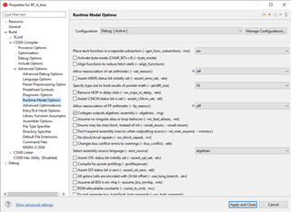

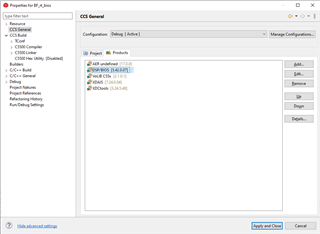

First of all, you installed the incorrect XDC tools version. It should be XDCTools 3.24.05.48, while you have installed 3.62.00.08.
Secondly, can you make sure that you get the same properties for your project?
Ming
Hi Ming,
Now I installed XDC 3.24.05.48 and ensured the project properties also.
Still facing the same issue.
it seems like some headers are being accessed from C:\ti\ccs1210\ccs\tools\compiler\ti-cgt-armllvm_2.1.2.LTS. But I could not find it in the property includes.
Is it really required or we need to remove?
Hima Bindu

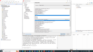

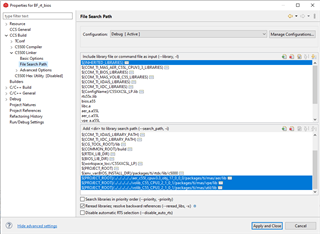

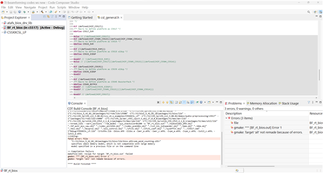

I was able to build the BF_rt_bios CCS project with the CCS 10.40.00 from C55xx_CSL 03.08.00 successfully. There are a few adjustments I have to made:
1. The DSP/BIOS version should be 5.42.00.07
2. Those library paths have to be adjusted:
Ming
Hi Ming,

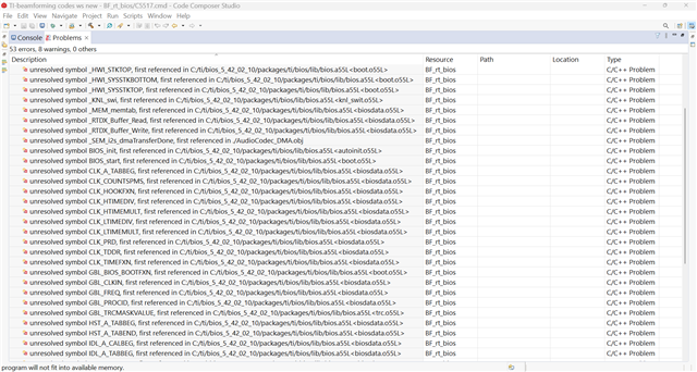

After the above change, the following are the errors.
1. errors in .cmd file. Memory allocation may need to be changed
2. Other errors are related to un resolved symbols in bios.a55L
Please help me to clear the above.
Hima Bindu.
Hi Hima,
Something is wrong with your CCS project. Are you using the CSL 03.08.01?
As you can see, the CMD file used in the BF_rt_bios is the VC5505_I2S.cmd:
and the DSP/BIOS generated CMD file - BF_rt_bios_cfg.cmd:
I do not know how come your CCS project is using the C5517.cmd.
Ming
Hi Ming,
Thank you,
The program build was successful when I mapped VC5505_I2S.cmd file as the linker command file.

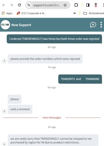

I have CMB card and did basic POC with 280049 launch pad.
When I'm trying to order C5517 EVM, it is not being taken and saying that the shipping to India is not possible.
If I start making the board with EVM reference, it will take 2 months to get the HW, So I need to get the EVM to complete my POC quickly.
Kindly suggest me on how to get the C5517 EVM to India.
Hima Bindu.
Hello Hima,
Unfortunately our product teams are not able to address any export related issues with shipments to countries. I am not certain why shipment to India would not be allowed but to resolve that issue, you will need to work with our Customer Support Center: https://support.ti.com/csm/
Ralph Jacobi
Hi Jacobi,
Thank you for your feedback.
Please find attached screenshot regarding the communication with support team.
can you please suggest me further.
Hima Bindu
Hello Hima,
I will make a couple inquiries if there is anything else I can provide, but chances are the feedback you received is a final answer on the topic. Neither Ming nor I have any control over export policies.
Ralph Jacobi
Hello Hima,
I have not been able to get any further information regarding this. I don't anticipate I will at this point, but if I happen to do so, I will post here it.
Sorry that we are unable to help you further regarding this issue, but those of us who help support via E2E have no control over TI's export control policies with these EVMs.
Ralph Jacobi
Hi Jacobi,
Thanks for your efforts and effort.
I could order it through Mouser. I might receive it in couple of days. Hope I will be able to do my POC.
Hima Bindu

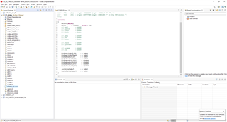

I started working on the EVM. I tried to do target configuration and then to load .out file.
when I open the .ccxml file, I could see the following instead of test connection.
I need your guidance to resolve this issue.
I would like proceed further with debugging the intermediate signals for bf, mss and asnr processes.
Kindly help to proceed further.
Hima Bindu.
