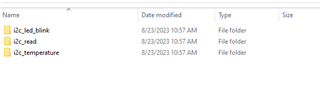

  • Hello Oba,
    You can see in the below image that I2C 0 is connected to on-board different EEPROM devices and an IO expander.
    MCU_I2C0 and MCU_I2C1 go to the safety connector. With these pins, you can easily interface any external devices.
    I2C_3 pins go to the HSE (high speed expansion connector), which can be used to interface any external devices, but you need an expansion connector.
    In I2C_1, there are different devices connected, like temperature devices, IO expanders, power supply monitoring ICs, etc.
    In MCU+SDK AM64X EVM, there are 3 examples available on I2C .
    i2c_led_blink example:  Uses I2C0 for IO expander
    i2c_read : Uses I2C1 for interfacing EEPROM devices.
    i2c_temperature :  Uses I2C1 for reading temperature.
    You can go through the examples below for more details.
    C:\ti\mcu_plus_sdk_am64x_09_00_00_31\examples\drivers\i2c
