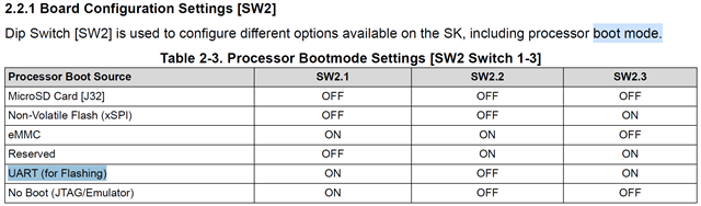

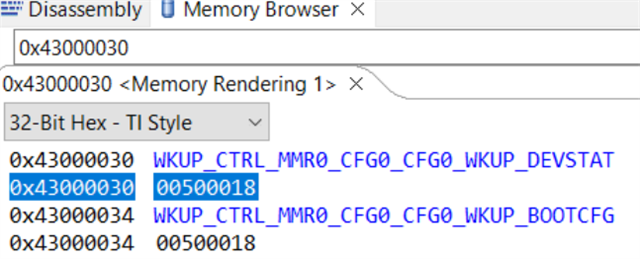

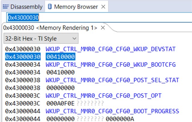

I got a E3 board, there is a TF card in the box,  and it is not empty, insert it to board and power up, not output on Console.
Then I created a TF card with tisdk-default-image-j784s4-evm.wic.xz download from: https://www.ti.com/tool/download/PROCESSOR-SDK-LINUX-AM69
also no output.
Then I change boot mode to UART, there is CCC output after a serial of character.
02000000011a00006a376165700000000000000048534653000801000008010002a60000000000002b28ecde967b79d61619f89cf29920
5c36d179cacb2b1c5a7f16e3169cc879602122d07ad47ae878a46e243c6f5078c04a5452faceeccb00d0453a5a5e6420daad0bc40b0000
00000000000000000000000000000000000000000000000000000000000000000000000000000000000000000000000000000000000000
00000032b2e1c111a6b6910358010404053c26928ac8032a6639ca7cd8e644e36de589CC
My power supply is 5V 3A , we ever encounter board keeping reset if the input power is not enough, but mine doesn't output.
