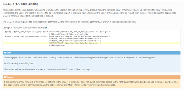

         As we think,  MCU1_0's application is started through SPL/uboot.  About ten seconds after powering on,it can start work successfully. It's too slow for us. We understand that MCU boot later in order to make MPU/Linux boot faster. Can we boot the MCU1_0 faster by SPL/uboot? If so, what should we do.
    Zhang
  • Hi Zhang
    In the SPL/u-boot flow, the MCU1_0 is actually the first firmware to be booted.
    R5 SPL boots A72 with A72 SPL and branches to the MCU1_0 application. Before you hit the A72 SPL or u-boot, the MCU1_0 is already running your application. In the documentation here, if you see the "Load R5 firmware, this is where the MCU1_0 application gets loaded which is much earlier than any other thing in the boot sequence.
    Probably there is something in your MCU1_0 firmware which is delaying the functionality?

            1.The MCU1_0 is actually the first firmware to be booted, and it's firmware includes DM and applications all started.
            2.The MCU2_0 MCU2_1 and other core  start  in kernel, but don't enable IPC.
            3.In vision_apps demo the script(vision_apps_init.sh) enable IPC for cores.
            Is that right?

  • Hi Zhang
       In kernel start, we can get remoteproc start MCU1_0(41000000.r5f). What do these states of mcu1_0 mean?
                                  ->  remoteproc remoteproc1: 41000000.r5f is available
                                 ->remoteproc remoteproc1: attaching to 41000000.r5f
                                 ->remoteproc remoteproc1: remote processor 41000000.r5f is now attached
    There are two modes in which Kernel becomes aware of the remote cores.
    1. Remote proc mode: this means that the kernel is actually loading the remote core firmware and taking the core out of reset. This is basically booting of the core by Linux Kernel.
    2. IPC only mode: this means that the kernel is just reading the resource table from the firmware and attaching to it. In this case the remote core is already booted and the kernel is only made aware of its existence so that it can talk to the remote core via IPC.
    In the usual SDK flow all cores are attached using only mode as all the cores (except MCU1_0) are already booted by u-boot and MCU1_0 is booted by R5 SPL.
    Attaching in IPC only mode is needed for A72 Linux to be able to do IPC with the core.
    MCU1_0 needs to have DM integrated and in the SPL/u-boot flow is the first core to be booted. This happens after the MCU1_0 has executed R5 SPL, it branches to the actual application on the MCU1_0. All the other cores, in this boot flow, are booted by the u-boot.
    No, in this boot flow, the MCU2_0 and MCU2_1 are started by the u-boot and they are just attached to the kernel in IPC only mode when the kernel boots.
    Below log which you attached before is where they get booted by u-boot.

         Thanks for your support. What role does /lib/firmware/j7-mcu-r5f0_0-fw play in the above process?
          We have a general understanding of the boot flow, but the results of our tests are inconsistent.

  • Hi
    This used to be there for Linux to read the resource table from the firmware, now there is a design-by-contract approach where the resource table for the firmware is located at a fixed DDR location. So once the application is loaded by R5 SPL, the Linux Kernel can just read the resource table from the DDR and this /lib/firmware/j7-mcu-r5f0_0-fw is not needed.

  • Hi,Karan
          1.we see /lib/firmware/j7-mcu-r5f0_0-fw is a must in 8.3. MCU1_0 Application Development with SYSFW — Processor SDK RTOS J721E.Is this document  no timely updated?
             2.Remoteproc mode need a rebooting to make MCU work on it. Is it possible that remoteproc caused the restart of MCU1_0?
    Zhang
  • Zhang
    This is no longer needed, seems like the document needs update.
