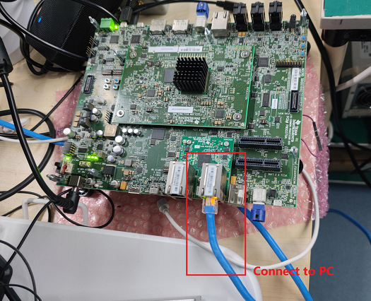

  • I tested the native ethernet in linux, but can't pinging, PC and A72 can recieve nothing. Below is my steps:
    Environment: j721e-evm board. linux:ti-processor-sdk-linux-adas-j721e-evm-09_00_01_02-Linux-x86-Install
                         PC connect board by QENET. As picture below:
    bridge setup:
    devlink dev param set platform/c000000.ethernet name switch_mode value true cmode runtime
    ip link add name br0 type bridge
    ip link set dev br0 type bridge ageing_time 1000
    ip link set dev eth1 up
    ip link set dev eth2 up
    ip link set dev eth3 up
    ip link set dev eth4 up
    ip link set dev eth1 master br0
    ip link set dev eth2 master br0
    ip link set dev eth3 master br0
    ip link set dev eth4 master br0

    When using ' iperf -c 192.168.1.255 -u -b 10M -t 9999 -i 1' to send broadcast message to board, find no increase num in 'ethtool -S eth2'.
    root@j721e-evm:~# [  811.308997] br0: port 2(eth2) entered disabled state
    [  811.313969] am65-cpsw-nuss c000000.ethernet eth2: Link is Down
    [  813.357106] am65-cpsw-nuss c000000.ethernet eth2: Link is Up - 1Gbps/Full - flow control rx/tx
    [  813.365752] br0: port 2(eth2) entered blocking state
    [  813.370712] br0: port 2(eth2) entered forwarding state
    root@j721e-evm:~#
    root@j721e-evm:~#
    root@j721e-evm:~# ethtool -S eth2

    Can you please share your device tree overlay file, as well as full Linux terminal log.
    Also, can you please share log of below in Linux terminal.
    root@J7-evm:# ls -la /lib/firmware/

  • overlay file:
    # This uEnv.txt file can contain additional environment settings that you
    # want to set in U-Boot at boot time.  This can be simple variables such
    # as the serverip or custom variables.  The format of this file is:
    #    variable=value
    # NOTE: This file will be evaluated after the bootcmd is run and the
    #       bootcmd must be set to load this file if it exists (this is the
    #       default on all newer U-Boot images.  This also means that some
    #       variables such as bootdelay cannot be changed by this file since
    #       it is not evaluated until the bootcmd is run.
    psdk_setup_file=.psdk_setup
    check_psdk_setup=load mmc 1:1 ${loadaddr} ${psdk_setup_file}
    # Reset to the default environment
    do_psdk_setup=env default -f -a; saveenv
    # If not done previously, then reset to the default environment and indicate this by writing a file
    # Also update the Linux hostname based on board_name
    uenvcmd=if run check_psdk_setup; then echo "Already setup."; else run do_psdk_setup; mw.b ${loadaddr} 0 1; fatwrite mmc 1:1 ${loadaddr} .psdk_setup 1; reset; fi; if test "$board_name" = "j721e-sk"; then ; setenv args_all $args_all systemd.hostname=tda4vm-sk ; fi; if test ${boot_fit} -eq 1; then  setenv name_overlays $name_overlays_fit; fi;
    # Setting the right U-Boot environment variables
    dorprocboot=1
    #name_overlays=ti/k3-j721e-evm-virt-mac-client.dtbo ti/k3-j721e-vision-apps.dtbo
    name_overlays=ti/k3-j721e-evm-quad-port-eth-exp.dtbo
    # Name overlays when booting from fit image
    name_overlays_fit=conf-ti_k3-j721e-evm-virt-mac-client.dtbo conf_k3-j721e-evm-quad-port-eth-exp.dtbo conf-ti_k3-j721e-vision-apps.dtbo
    I have replace  vx_app_rtos_linux_mcu2_0.out&vx_app_rtos_linux_mcu2_1.out  with ipc_test. So the ethfw not work.
    You mean, rebuild the app without EthFw and using the updated binary? If not, can you please disable EthFw from vision apps and rebuild the application for MCU2_0 and map the generated binary for Main R5F0_0 core and check.
    As requested above, can you please provide full Linux terminal log.
    Sudheer
  • You mean, rebuild the app without EthFw and using the updated binary?
    I didn't rebuild the whole vision apps. I just replace the ethfw(vx_app_rtos_linux_mcu2_0.out&vx_app_rtos_linux_mcu2_1.out) with other fw not running eth.
