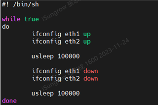

The source code for the up and down network cards is as follows:

    I didn't run any applications, just connected the network port to the switch, which may have had low-frequency network communication with AM5716. On the contrary, after unplugging the network cable, there will be no errors when I keep up/down the network port
    ps. The network card is transmitting network data during down/up
    So, in your statement above, its just the background data and not any data you are specifically sending?
    Also, in your application, you are scheduling interface down every 100ms and then once every 500ms, you are bringing the interface up. When you have the cable connected, I am guessing the interface won't be able to come up in 100ms when the next link down command is scheduled. So, the links would be always down when this script is executed.
    Is this analysis correct?

  • Dear Tanmay,
    Yes, we did. We run the following script and it got bad result like before.
