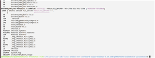

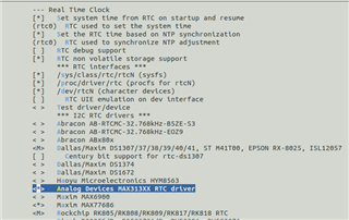

by default there is no driver for RTC MAX31331. I have updated from git and enabled RTC MAX31331. from the kernel build, I can see the corresponding file is included in the image. attached the images below.

root@am62xx-evm:~# dmesg | grep rtc
[    1.334101] rtc-ti-k3 2b1f0000.rtc: registered as rtc0
[    1.339312] rtc-ti-k3 2b1f0000.rtc: setting system clock to 1970-01-01T00:00:02 UTC (2)
root@am62xx-evm:~# dmesg | grep RTC
root@am62xx-evm:~# dmesg | grep i2c
[    0.812420] i2c /dev entries driver
[    1.000155] omap_i2c 20000000.i2c: bus 0 rev0.12 at 400 kHz
[    1.007578] omap_i2c 20010000.i2c: bus 1 rev0.12 at 100 kHz
[    1.014790] omap_i2c 20020000.i2c: bus 2 rev0.12 at 100 kHz
root@am62xx-evm:~#
Also I added some extra prints to check if the drive is initialized in the "max313xx_probe()" function. but  I dont see those messages in the log messages.
static int max313xx_probe(struct i2c_client *client,
              const struct i2c_device_id *id)
    struct device *dev = &client->dev;
    struct max313xx *max313xx;
    struct device *hwmon;
    const void *match;
    int ret;
    dev_err_probe(dev, PTR_ERR(max313xx->regmap),
                     "TPPR RTC Probe\n");
    max313xx = devm_kzalloc(&client->dev, sizeof(*max313xx), GFP_KERNEL);
    if (!max313xx)
        return -ENOMEM;
        dev_set_drvdata(&client->dev, max313xx);
    max313xx->regmap = devm_regmap_init_i2c(client, &regmap_config);
    if (IS_ERR(max313xx->regmap)) {
        return dev_err_probe(dev, PTR_ERR(max313xx->regmap),
                     "regmap init failed\n");
    i2c_set_clientdata(client, max313xx);
    match = device_get_match_data(dev);
    if (match)
        max313xx->chip = match;
    else if (id)
        max313xx->chip = (struct chip_desc *)id->driver_data;
    else
    return -ENODEV;
    max313xx->id = max313xx->chip - chip;
    dev_dbg(dev, "RTC_ID: %d\n", max313xx->id);
    dev_warn(dev, "max313xx_probe : RTC_ID: %d\n", max313xx->id);
could you please help us?
