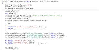

  I used demo with app_single_cam,  in write_output_image_raw,  I see that the remarks only support unpacking raw12
But The size of the data saved is the amount of data in RAW16
camera resolution is 1280*720 ,date type is RAW16
 when i use the dcc tuning tools open the RAW16 Image, it's very black, use RAW12 to review is ok, What is the reason for this?
