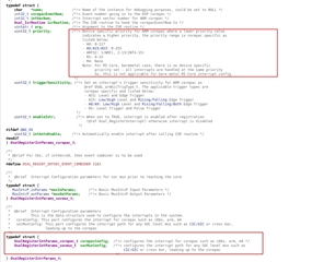

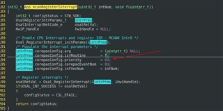

    This is the interrupt priority of CAN and should have the interrupt configured to the highest priority:
