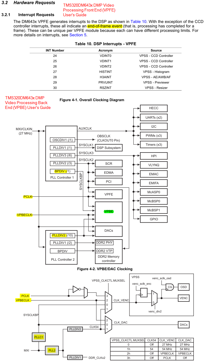

There are two pieces of information I notice that might have relation to this synchronization problem:
1.    For VPFE, there are interrupts indicating end-of-frame events.
2.    For VPBE, there are as many as four clock sources for VPBE.VENC, including PCLK which is VPFE's input clock.
So should VPFE.PCLK be used here? If it is used, although at the first glance there seems to be an apparently simple synchronization mechanism PCLK affords, if we think in more detail the case might not be as simple as expected. Because:
1.    VPFE.PCLK is pixel level sync clock, not frame level clock. Frame sync signal VSYNC is either separately provided or embedded in video signal if the input stream if ITU/BT.656.
2.    Interrupt events VDINT0 and VDINT1, perhaps also some others, are already capable effectively communicating the end-of-frame information.
Therefore, I am very curious in knowing the purpose of allowing PCLK to be VPBE.VENC's clock input. What is the purpose of this design? And how could it address the frame synchronization between arose due to different input/output frame for video stream?
Besides VPFE.PCLK, does other three clock sources (PLLC1, PLL2, VPBECLK) of VPBE help? In detail, how?

  • Zheng,
    1. 30fps in, 60 fps out, you can simply display each input frame twice.
    2. regarding 24fps in, 60 fps out, consider "pulldown", explained here http://www.zerocut.com/tech/pulldown.html
    The EOF events are definitely helpful here, and should be used.
    Do the input clock and output clock have the same frequency? PCLK is only useful when you want to synchronize the pixel of input and output, and that they have the same rate. I don't think this is what you are doing. My impression is that you are only trying to synchronize the input and output video stream.
