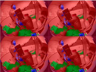

I have tested that object array obj->input.myarr has all four channel outputs.
I am getting mosaic dumps
this is the first dump which has camera 0 output in all four images, the next dump has camera 1, and so on.
We are filling the post-proc output in the same way it is filled in other applications for multiple channel

  • Hi Vyom,
    This part is not correct
    if (obj->pipeline <= 0)
    // make name
    makeCaptureFilename(camera_frame_name, 128, *frame_id);
    vx_char output_file_name[500];
    fill_ObjectArray(obj->cdc.last_images[0],obj->input.myarr[0]); //vx_image to vx_object_array
    fill_ObjectArray(obj->cdc.last_images[1],obj->input.myarr[1]);
    fill_ObjectArray(obj->cdc.last_images[2],obj->input.myarr[2]);
    fill_ObjectArray(obj->cdc.last_images[2],obj->input.myarr[3]);
    /* Enqueue inputs during pipeup dont execute */
    status = vxGraphParameterEnqueueReadyRef(obj->graph, obj->scalerObj.graph_parameter_index, (vx_reference*)&obj->myinput_images[obj->enqueueCnt], 1);
    Here you are filling 4 buffers at a time and obj->pipeline would be incremented only once. This is not how pipe up should be done.
    I think you are confused between multi-channel and buffer depth.
    The one you are doing now is filling all 4 buffers of all 4 channels.
    Could you please refer the implementation of readScalerInput() in the avp3 demo.
    Nikhil
  • Dear Sir,
    Thanks for the explanation and suggestions.
    I made the mistake and got confused.
    I am getting the correct output now.

     GRAPH: mando_tidl_od_app_graph (#nodes =   4, #executions =     64)
     NODE:  VPAC_MSC1:               ScalerNode: avg =  44256 usecs, min/max =  13193 / 132306 usecs, #executions =         64
     NODE:      DSP-1:              PreProcNode: avg =   4342 usecs, min/max =   4246 /   4431 usecs, #executions =         64
     ### APP_DEBUG: Frame:66
     NODE:   DSP_C7-1:                 TIDLNode: avg =  62298 usecs, min/max =  55614 /  63802 usecs, #executions =         65
     Frame num:66
     NODE:      DSP-2:          SegPostProcNode: avg =  27568 usecs, min/max =  22814 /  30764 usecs, #executions =         65
     PERF:                 : avg =      0 usecs, min/max =      0 /      0 usecs, #executions =          0
     PERF:                 : avg = 104456 usecs, min/max =      0 / 225679 usecs, #executions =         65
     PERF:                 :    9.57 FPS
    fps : 9.57 FPS
    unused DDR : 2 %
    Thanks and Regards,
    Vyom Mishra
  • Hi Vyom,
    2% was a bug which is fixed in the latest releases. It is a calculation mistake.. but you still have 178MB free.
    Here I see ScalarNode, PreProc, TIDL and PostProc. Here TIDL time is 60+ msec, which would automatically result in graph to run at 15 fps.. It should be at 33.33 msec for 30 fps.
    I am feeding the scalar node the camera input at 30FPS.
    Apart from this you had mentioned the above. I do not see a node for that. Could you tell if this is file read and then input to Scalar node? If yes, then there would be file read latency as well which would affect the FPS.
    Nikhil
  • Dear Sir,
    Thanks for the quick response!
    This is tested with real-time 30fps.
    Here I see ScalarNode, PreProc, TIDL and PostProc. Here TIDL time is 60+ msec, which would automatically result in the graph running at 15 fps.. It should be at 33.33 msec for 30 fps.
    For this, we will reduce the input resolution of the DL Model
    Anything else could be done to reduce this time?
    Thanks and Regards,
    Vyom Mishra
    Yes, this would help. Let us try with this.
    The camera Application is running parallel and we are accessing the data through the server-client model
    May I know how you are feeding this to MSC node exactly?
    Nikhil
  • Dear Sir,
    I have copied vx_image buffer[4] to vx_object_array.
    if(status == VX_SUCCESS)
    		status = app_create_graph_scaler(obj->context, obj->graph, &obj->scalerObj,  obj->input.myarr[0]);
    		APP_PRINTF("Scaler graph done!\n");
    		printf("[SCALER-MODULE-CREATE] Exit! \n");
    obj->input.myarr[q]     = vxCreateObjectArray(obj->context, (vx_reference)input, 4);
    where q is Q Depth
    Thanks and Regards,
    Vyom Mishra
  • Yes, this is understood, but how are you getting the vx_image filled with capture data?
    Usually an OpenVX node is used to fill the vx_image or it would be imported from another application and then data would be filled. May I know what is your approach?
    Nikhil
  • Dear Sir,
    It is a separate application which uses a capture node to get the data from the sensor and just uses indexing it referenced from the object array to vx_image type.
    Thanks and Regards,
    Vyom Mishra
  • Ok,
    Coukd you do one more experiment?
    The scalar node perf shows around 44ms... for 30 fps it should have been less than 33ms...
    Could remove the other part of the graph and just receive frames from camera to scalar node and check of you are getting 30fps from scalar node output?
    Nikhil
