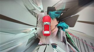

  • Hi Brijesh,
    The use case should like this:
    Create two display nodes, one for camera image and another for surround view output image.
    Sometimes I need to show full size of surround view output like below
    (Sorry that the cameras are not installed and calibrated)
    And sometimes I need to show single camera and cropped surround view image together.
    This is why I need to change not only cropParam, but also posX/posY/outWidth/outHeight.
    Because the destination x/y/w/h for surround view display node is different.
    Thanks.
    Christopher

  • Hi Brijesh,
    Sorry I am a bit confused about display parameters setting ..
    Blow images shows two display modes I need to switch during graph is running.
    The first display mode shows full size image of surround view output
    In this display mode, the parameter setting of srv display node is as below
        display_params.cropPrms.startX = 0;
        display_params.cropPrms.startY = 0;
        display_params.cropPrms.width = 1920;
        display_params.cropPrms.height = 1080;
        display_params.outWidth = 1920;
        display_params.outHeight = 1080;
        display_params.posX= 0;
        display_params.posY= 0;
    And the second display mode shows both camera view and cropped srv view
    (Please ignore the left side camera view which is controlled by another display node)
    In 2nd display mode, the paremter settings of srv display node is as below:
        display_params.cropPrms.startX = 660;
        display_params.cropPrms.width = 600;
        display_params.outWidth = 600;
        display_params.posX= 1320;
    So if I want to swich to 2nd display mode from 1st display mode, the posX need to be changed from 0 to 1320, and outWidth need to be changed from 1920 to 600.
    Since posX and outWidth are not belong to tivx_display_crop_params_t  sturct, they are not able to be update by TIVX_DISPLAY_SET_CROP_PARAMS ioctl..
    If I have any misunderstanding, please feel free to correct me.
    Thanks for the help.
    Christopher
