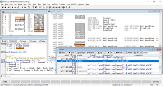

  • Hello Thomas,
    I tested SDK8.2 WDT on AM335x GP EVM.
    The attached screenshot lists where WDT is enabled in SPL.
    I'm also attaching the matching call flow for your reference.
    -Hong

    B::Var.Frame_/Locals_/Caller
    -000|hw_watchdog_init()
        |  wdt = 0x44E35000
        |  __v = 0x4444
    -001|spl_board_init()
        |#endif
        |#if defined(CONFIG_HW_WATCHDOG) || defined(CONFIG_WATCHDOG)
     303|        hw_watchdog_init();
    -002|board_init_r(dummy1 = ?, dummy2 = ?)
        |  dummy1 = ?
        |  dummy2 = ?
        |  spl_boot_list = (0x0, 0x0, 0x0, 0x0, 0x0)
        |  spl_image = (name = 0x0, os = 0x11, load_addr = 0x80800000, entry_point = 0x80800000, fdt_addr = 0x8088508C, boot_device = 0x8, size = 0x0008508C, flags = 0x2, arg = 0x88000000)
        |#endif
        |        if (CONFIG_IS_ENABLED(BLOBLIST)) {
        |                ret = bloblist_init();
        |                if (ret) {
        |                        debug("%s: Failed to set up bloblist: ret=%d\n",
        |                              __func__, ret);
        |                        puts(SPL_TPL_PROMPT "Cannot set up bloblist\n");
        |                        hang();
        |        if (CONFIG_IS_ENABLED(HANDOFF)) {
        |                ret = setup_spl_handoff();
        |                if (ret) {
        |                        puts(SPL_TPL_PROMPT "Cannot set up SPL handoff\n");
        |                        hang();
        |#if CONFIG_IS_ENABLED(BOARD_INIT)
     641|        spl_board_init();
    -003|board_init_r(dummy1 = ???, dummy2 = ???)
        |  dummy1 = ???
        |  dummy2 = ???
        |#ifndef BOOT_DEVICE_NONE
        |#define BOOT_DEVICE_NONE 0xdeadbeef
        |#endif
  • What was the defconfig settings used for this?
  • Hello Thomas,
    am335x_evm_defconfig
    -Hong
