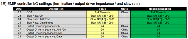

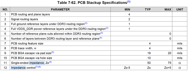

#1. In the EMIF tools, TI recommend output driver impedance CLK, DQS is 44ohm, but on datasheet, single ending impedance range is 50- to 75ohm, +-5ohm, should it at least 45ohm?

  • #1, The value in the spreadsheet is the output driver impedance of the IO buffer, and the spec you point to is the trace impedance of the board.  The recommendation is simply a good value to start with, you may have to adjust based on your board design to achieve impedance matched signals.  Also note that DQS and clk are differential signals
