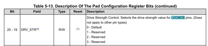

Is there any way to modify drive strength of IO configured in LVCMOS ?
It seems that it isn't possible :
It could be very usefull to manage RGMII interfaces.
What is the equivalent output impedance?
Thanks.
Drive strength configuration is currently not supported. The default drive strength is it is the only configuration used for SoC-level timing closure.
Let me check internally and update you.

What is the equivalent output impedance?Let me check internally and update you.
Yes I believe 60 ohm is the correct equivalent impedance corresponding to the nom drive strength setting for LVCMOS
