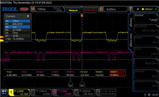

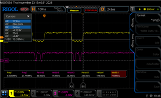

       We are using TMS320C6655 DSP processor. We have tried with EMIF interface with DMA transfer as well as without DMA.
We are getting the data rate with maximum of 5 MHZ approximately whereas ,it should be 32 MHZ max according to the theoretical data.
 I will share the probing images with frequency and width time period datas.
 Please look into it and kindly support for the low data rate query.
 Probing datas are with Chip select and write enable pin
 Thilak

  • Hi Shankari,
               I have sent a query for EMIF16 peripheral ,not DDR EMIF that you have mentioned.EMIF16 interface is being used where we face low data rate issue.
    Please suggest.

     I have shared the emif configuration settings that we are using .We have configured with minimum as well as maximum values for the setup,strobe and hold But there isn't much difference

  • Hi Shankari,
                   EMIF16 peripheral We are using for communicating between dsp and Cyclone5 Fpga. We are sending data from DSP to FPGA and probing the DSP EMIF (WE and CS) signals.
    Thats the data that has been shared.
    Pls revert.
    Thilak
  • Thilak,
    Please give details about how the Cyclone5 FPGA is configured-and-interfaced to the EMIF16 of C6657.
