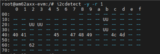

Hi TI Team,
SDK:ti-processor-sdk-linux-edgeai-am62axx-evm-09_00_01_03-Linux-x86-Install.bin
sensor:ov5647
I'm bringing up ov5647, following this document.
After compiling the code
make linux
export PATH=/home/ruihua.pan/ti/linux-devkit/sysroots/x86_64-arago-linux/usr/bin/aarch64-oe-linux:$PATH
make ARCH=arm64 CROSS_COMPILE=aarch64-oe-linux-  distclean
make ARCH=arm64 CROSS_COMPILE=aarch64-oe-linux-  defconfig ti_arm64_prune.config
make ARCH=arm64 CROSS_COMPILE=aarch64-oe-linux- Image
make ARCH=arm64 CROSS_COMPILE=aarch64-oe-linux- modules
make ARCH=arm64 CROSS_COMPILE=aarch64-oe-linux- dtbs
Remove the SD card from the AM62A7-LP board.
Insert the SD card into the PC and mount it:
sudo mount /dev/sdb2 /mnt/usb
Then, I can access and manipulate SD card files.
I did following steps to install kernel modules:
      $ sudo cp arch/arm64/boot/Image /mnt/usb/boot/boot
      $ sudo cp arch/arm64/boot/dts/ti/k3-am62a7-sk-csi2-ov5647.dtbo /mnt/usb/boot/dtb/ti
      $ sudo make ARCH=arm64 INSTALL_MOD_PATH=/mnt/usb/lib/modules/6.1.46-gf8110d9ce8 modules_install
5141.ti_ov5647.zip
I set the dts overlay in boot mode using following command:
      $ setenv name_overlays ti/k3-am62a7-sk-csi2-ov5647.dtbo
      $ env export -t $loadaddr <list of variables>
      $ fatwrite mmc ${mmcdev} ${loadaddr} ${bootenvfile} ${filesize}
Based on what I did above, which step was wrong?
Daohong
  • Hello Daohong,
    I noticed a few things in your first step and 3rd step in installing kernel modules:
    The first step should be:
    The third step should be:
    sudo make ARCH=arm64  INSTALL_MOD_PATH=<path to root of file system> modules_install
    For example, I have the following in my PC:
    $ lsblk
    sdc      8:32   1   7.4G  0 disk
    ├─sdc1   8:33   1 134.1M  0 part /media/jxu/boot
    └─sdc2   8:34   1   7.3G  0 part /media/jxu/root
    Then I'll need to do:
    sudo make ARCH=arm64  INSTALL_MOD_PATH=/media/jxu/root/ modules_install
    The make command will take care of installing the right modules to /lib/modules.
    To be consistent, you can do the first step as:
    sudo cp arch/arm64/boot/Image /media/jxu/root/boot
    Please try these and see if it works. If it doesn't work, please share a dmesg log.
    Jianzhong
  • Hi Jianzhong,
    My complete steps:
    touch k3-am62a7-sk-csi2-ov5647.dtso:
    // SPDX-License-Identifier: GPL-2.0
     * Copyright (C) 2022 Texas Instruments Incorporated - https://www.ti.com/
    /dts-v1/;
    /plugin/;
    #include <dt-bindings/gpio/gpio.h>
    	fragment@101 {
    		target-path = "/";
    		__overlay__ {
    			clk_ov5647_fixed: ov5647-xclk {
    				compatible = "fixed-clock";
    				#clock-cells = <0>;
    				clock-frequency = <25000000>;
    &main_i2c2 {
    	#address-cells = <1>;
    	#size-cells = <0>;
    	status = "okay";
    	i2c-switch@71 {
    		compatible = "nxp,pca9543";
    		#size-cells = <0>;
    		reg = <0x71>;
    		/* CAM port */
    		i2c@1 {
    			#size-cells = <0>;
    			reg = <1>;
    			ov5640: camera@36 {
    				compatible = "ovti,ov5647";
    				reg = <0x36>;
    				clocks = <&clk_ov5647_fixed>;
    				clock-names = "xclk";
    				// reset-gpios = <&exp1 13 GPIO_ACTIVE_HIGH>;
    				pwdn-gpios = <&exp1 13 GPIO_ACTIVE_LOW>;
    				port {
    					csi2_cam0: endpoint {
    						remote-endpoint = <&csi2rx0_in_sensor>;
    						// link-frequencies = /bits/ 64 <456000000>;
    						clock-lanes = <0>;
    						data-lanes = <1 2>;
    &csi0_port0 {
    	status = "okay";
    	csi2rx0_in_sensor: endpoint {
    		remote-endpoint = <&csi2_cam0>;
    		bus-type = <4>; /* CSI2 DPHY. */
    		clock-lanes = <0>;
    		data-lanes = <1 2>;
    vim arch/arm64/boot/dts/ti/Makefile
    k3-am62a7-sk-csi2-ov5647-dtbs := k3-am62a7-sk.dtb k3-am62a7-sk-csi2-ov5647.dtbo
    board-support/linux-6.1.46+gitAUTOINC+f8110d9ce8-gf8110d9ce8/arch/arm64/configs/defconfig:800:CONFIG_VIDEO_OV5647=m
    board-support/linux-6.1.46+gitAUTOINC+f8110d9ce8-gf8110d9ce8/arch/arm/configs/imx_v6_v7_defconfig:267:CONFIG_VIDEO_OV5647=m
    board-support/linux-6.1.46+gitAUTOINC+f8110d9ce8-gf8110d9ce8/arch/arm/configs/sama7_defconfig:147:CONFIG_VIDEO_OV5647=m
    board-support/linux-6.1.46+gitAUTOINC+f8110d9ce8-gf8110d9ce8/drivers/media/i2c/Makefile:89:obj-$(CONFIG_VIDEO_OV5647) += ov5647.o
    board-support/linux-6.1.46+gitAUTOINC+f8110d9ce8-gf8110d9ce8/.pc/0001-arm64-defconfig-Enable-CONFIG_GPIO_SYSFS.patch/arch/arm64/configs/defconfig:799:CONFIG_VIDEO_OV5647=m
    make linux
    sudo make ARCH=arm64  INSTALL_MOD_PATH=mnt/usb/ modules_install
    sudo umount /dev/sdb2
     Remove the SD card from the PC and insert it into the AM62A7-LP
    boot

    Ruihua
  • Hello Ruihua,
    Thanks for providing the details. I don't see anything related to OV5647 in your dmesg. If everything works correctly, there should be a message as below:
    root@am62axx-evm:~# dmesg | grep ov5647
    [    7.888355] ov5647 4-0036: Consider updating driver ov5647 to match on endpoints
    If you do a "lsmod | grep ov5647", what do you see? It should show the following:
    root@am62axx-evm:~# lsmod | grep ov5647
    ov5647                 20480  0
    v4l2_fwnode            20480  1 ov5647
    v4l2_async             24576  2 v4l2_fwnode,ov5647
    videodev              245760  7 v4l2_async,ov5647,videobuf2_v4l2,videobuf2_common,v4l2_mem2mem,e5010_jpeg_enc,wave5
    mc                     57344  6 v4l2_async,videodev,ov5647,videobuf2_v4l2,videobuf2_common,v4l2_mem2mem
    Can you try to manually load the ov5647.ko if it's not already loaded, e.g.,
    insmod /lib/modules/<modified linux kernel>/kernel/drivers/media/i2c/ov5647.ko
    Or try the following and see what happens:
    root@am62axx-evm:~# modprobe -r j721e_csi2rx cdns_csi2rx ov5647
    root@am62axx-evm:~# modprobe -a j721e_csi2rx cdns_csi2rx ov5647
    [  710.731602] cdns-csi2rx 30101000.csi-bridge: Probed CSI2RX with 2/4 lanes, 4 streams, external D-PHY
    [  710.770626] ov5647 4-0036: Consider updating driver ov5647 to match on endpoints
    Also for a sanity check, if you do "uname -r", does it show the modified kernel?
    Jianzhong
  • Hi Jianzhong,
    I added logs to ov5647.c and found that there was an issue with i2c.
    root@am62axx-evm:/opt/edgeai-gst-apps# lsmod | grep ov5647
    ov5647                 20480  0
    v4l2_fwnode            20480  2 ov5647,cdns_csi2rx
    v4l2_async             24576  4 v4l2_fwnode,j721e_csi2rx,ov5647,cdns_csi2rx
    videodev              245760  9 v4l2_async,j721e_csi2rx,ov5647,videobuf2_v4l2,cdns_csi2rx,videobuf2_common,v4l2_mem2mem,e5010_jpeg_enc,wave5
    mc                     57344  8 v4l2_async,videodev,j721e_csi2rx,ov5647,videobuf2_v4l2,cdns_csi2rx,videobuf2_common,v4l2_mem2mem
    root@am62axx-evm:/opt/edgeai-gst-apps# dmesg | grep ov5647
    [    6.329251] ov5647 4-0036: ov5647_write: i2c write error, reg: 0x3000
    [    6.340025] ov5647 4-0036: write sensor_oe_enable_regs error
    [    6.352370] ov5647: probe of 4-0036 failed with error -121
    [    0.000000] Booting Linux on physical CPU 0x0000000000 [0x410fd034]
    [    0.000000] Linux version 6.1.46 (ruihua.pan@bric) (aarch64-oe-linux-gcc (GCC) 11.3.0, GNU ld (GNU Binutils) 2.38.20220708) #1 SMP PREEMPT Wed Nov 29 04:03:09 UTC 2023
    [    0.000000] Machine model: Texas Instruments AM62A7 SK

    It hasn't been successfully mounted on the I2C bus yet.
