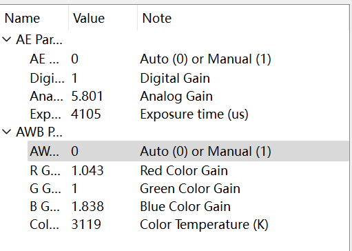

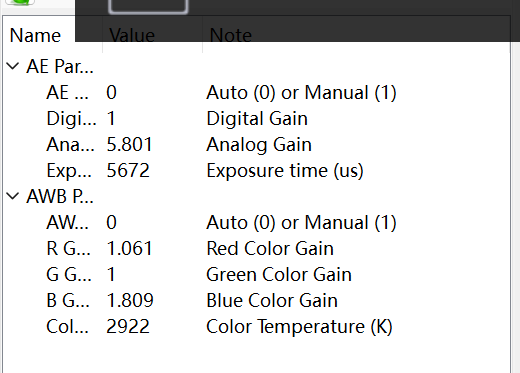

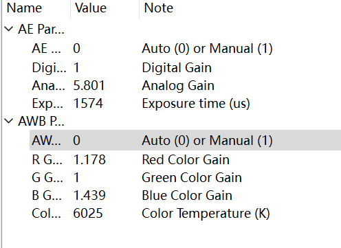

Currently, there is an issue of inaccurate calibration of AWB low color temperature using DCC.
The following is the gain value and corresponding result graph displayed by the calibrated AWB algorithm on DCC.
We can see that under A-light, the Bgain value is relatively small, resulting in a yellowed image.
After multiple AWB calibrations, the results are similar.
I want to know if calibration will cause the current problem?If so, which step should I pay attention to?

  • Hi Peng
    The estimated color temperature under A light is to high, which results in a yellowed image. I think the problem lies on the calibration process since there are leaps in your calibration result.
    I suggest remove the image under 4848K and try calibration once. It's possible there are problems with this 4848K light source.

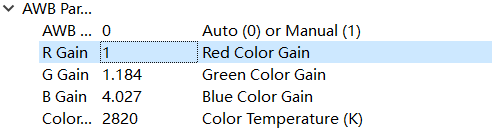

  • Hi Adam
    The following are the results after removing the color temperature of 4848.
    Although the color temperature estimation is indeed more accurate, the gain value has not changed.
    Is the gain value not directly related to the estimated color temperature value?
  • Hi Peng
    The gain value is directly related to the estimated color temperature value and the calibration results.
    It seems to me that the gain values has changed a little compared with this:
    So what is the true color temperature of your A light? And would you please place the image under A light into DCC tuning tool and calibrate once more to see if the A light consistent with the interpolated calibration results? If you do so, please provide a calibration result like this

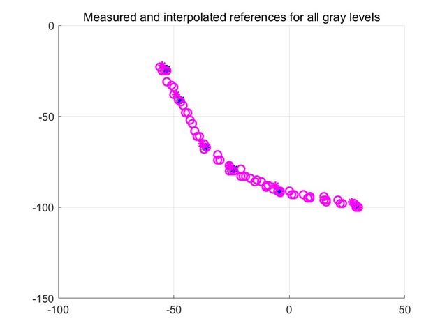

  • Hi Adam
    2755K
  • The black level is not tuned correctly according to this result:
    The tuned result should be in one line not in multiple lines like yours.
    Please subtract the black level in your decompanding LUT input to the DCC tuning tool and calibration once again to see if the problem solved.

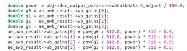

  • Hi Gang
    Ti_ 2a_ Why is the gain value raised to the power of 0.6 in the wapper. c file?
  • Hi Peng
    If awb gain is applied in VISS, the gain is applied on an image with gamma (0.6 in your case).
