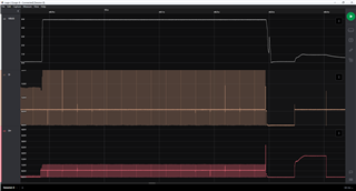

With this configuration I can set the session bit and it remains active, triggering enabling of VBUS. However shortly after that, the VBUS is driven low again, and the peripheral reports a babble error. Also, when inspecting the data lines through a logic analyser the bus behaves very weird (see included capture). The DEVCTL[BDEVICE] is never set to "A" device.
Some details about the capture:
- the pulses on D- starting at 0.2s are short pulses (600ns) 1ms apart
- the pulses on D- get longer when the pulses on D+ start (600ns -> 1.5us), but are still happening every 1ms
- the pulses on D+ are 900ns and happen simultaneously with the pulses on D- (SE1)

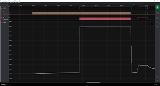

An analog capture reveals that D+ and D- float at around 560mV:
I do not know where to look next to find what is failing.

    To transition the MUSB controller to host mode, 1) directly ground the USB_ID pin, 2) set DEVCTL bit0 to 1, which pull high USB_DRVVBUS pin to turn on VBUS power supply.
    The MUSB controller user guide do not recommend to use TESTMODE[FORCE_HOST] for normal host mode operation.
    However, the MUSB controller is sensitive to the VBUS_IN pin signal: before step 2) above to set DEVCTL[bit0], VBUS_IN should be 0v. After DEVCTL[bit0] is set to 1, VBUS_IN pin should sense 5v (~4.7v?) within 100msec. Otherwise, the MUSB controller won't transition to host mode.

    As for the ID pin, our system has this pin floating like I mentioned in my original post. We do have a testpad connected to it, so I did try connecting that to a spare GPIO and controlling the ID pin like that. When I do this, the peripheral now becomes an A device in host mode (DEVCTL[BDEVICE] = 0; DEVCTL[HOSTMODE] = 1). The code then ends up in the 'device connected' state in which it tries to read the device descriptor of the connected device. An improvement. However, this is not really an option for us since we already have systems in the field.
    Is there any way of overriding the ID pin state through a register that I missed? (I did not find reference for such things in the reference manual, other than the force host setting)
    Is there any other way of transitioning the peripheral to host mode?
  • Hi Luc,
    Unfortunately, the MUSB controller doesn't have a register bit to override the ID pin status.
    The ID pin is float if it is not pined out or not accessible, then the controller can only works in device mode. There is no other way to switch to host mode without directly grounding the ID pin.
