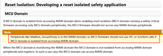

1 I noticed that the m-core manual mentioned that when the m-core runs independently, the peripherals and resources of the a-core cannot be used, including the ipc function. Would I like to confirm that this is true?
2 If so, the multinuclear heterogeneity loses its meaning. Will the problem be solved later?

    Currently, in MCU+SDK, we support partial isolation, which means that only the reset path is isolated from the main domain and MCU peripherals can be accessed from the main domain or vice versa.
    If MCU is configured in fully isolated mode, then the below understanding is correct.

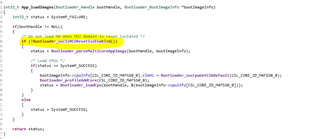

    I want to use the sbl boot mode because such that the A53 core no longer loads the m4 core so that the m4 core can separate from the effects of the A53 core
    if you use the sbl_ospi_linux boot mode, then SBL will skip loading the M4 core app image for every reset, and this is already taken care in the SBL.

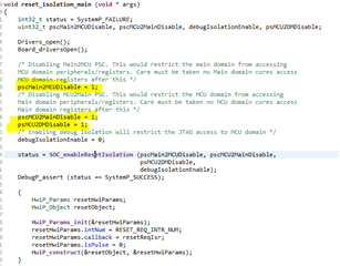

  • 1  I want to transfer data from A53 to M4F, and from M4F to A53.
    2 I didn t find this use case ,so I want to ask if enable ipc functionality in the isolation software?
    3 In the official manual, it cannot be achieved simultaneously. So I want to confirm with you that the manual is correct.
    4 If you say you can implement both ipc and safe-save _ isolation I can try modifying it
    This is not possible with the current isolation software. Please look at the image below.
    I have highlighted below the yellow colors where bits are used to restrict cross-domain peripheral access.
    So, you can't use ipc or access peripherals from MAIN to MCU or MCU to MAIN.
    But, for your use case, you can keep the below bit as 0 instead of 1. So, reset isolation and ipc functionality should work.
    pscMCU2MainDisable = 0;
    Note: If you control this bit, it means your MCU domain is accessing the main domain and Reset is isolated.
    If you want full isolation as the MCU domain can be configured as a safety controller , this bit should be 1.

    There is no problem, but you can access the MCU peripherals from the main domain. Other than this, there is no problem, and I have added the same comments in the below note.
