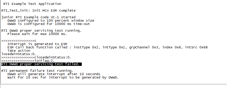

Customer is using TDA4VM ECO device. He is running SDL examples/rti/UC1 example in ti-processor-sdk-rtos-j721s2-evm-08_06_01_03.
1. Enable watchdog, the watchdog timer doesn't exceed 10s, but the WD is triggered. It prompted "RTI DWWD proper servicing test failed."
Have TI tested the example?
The log is below
    Is this just the standard standalone SDL example or has the customer made any changes?
    Josiitaa
  • Hi:
    I am using TDA4VE88TGAALZRQ1 device.
    This is the standard standalone SDL example,I did not modify the code。

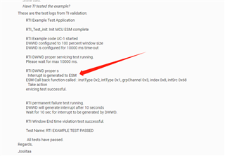

    These are the test logs from TI validation:
    RTI Example Test Application
    RTI_Test_init: Init MCU ESM complete
    RTI Example code UC-1 started
    DWWD configured to 100 percent window size
    DWWD is configured for 10000 ms time-out
    RTI DWWD proper servicing test running.
    Please wait for max 10000 ms.
    RTI DWWD proper s
      Interrupt is generated to ESM
    ESM Call back function called : instType 0x2, intType 0x1, grpChannel 0x3, index 0x8, intSrc 0x68
      Take action
    ervicing test successful.
    RTI permanent failure test running.
    DWWD will generate interrupt after 10 seconds
    Wait for 10 sec for interrupt to be generated by DWWD.
    RTI Window End time violation test successful.
    Test Name: RTI EXAMPLE TEST PASSED
     All tests have passed.
    Josiitaa
  • As shown in the log provided by TI, why did an interrupt occur?

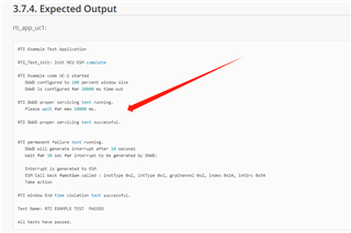

  • Hi:
        The log in the following link you provided is shown in the figure below, but it did not trigger an interrupt event.Why are the results different from the test logs verified by TI?
    https://software-dl.ti.com/jacinto7/esd/processor-sdk-rtos-j721s2/08_06_01_03/exports/docs/sdl/sdl_docs/userguide/j721s2/examples/rti.html
    It seems like the logs for the expected interrupt is printed earlier. I will verify this with the internal experts and get back to you by Friday(Dec-8) EOD.
