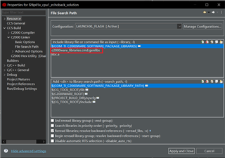

Refer to the document EtherCAT_SubordinateDevice_ under C2000Ware_5_01_00_00\libraries\communications\EtherCAT\f28p65x\docs section 4.3 Scanning for EtherCAT Devices via TwinCAT in Controller_Software_User_Guide.pdf, the following issues were encountered when implementing EtherCAT functionality:
1) When using the f28p65x_cpu1_pdi_hal_test_app routine to compile the option LAUNCHXL_flash, the project reports the following error: "#1008-D cannot find file "c2000ware_libraries.cmd.genlibs".
The file cannot be found in the project directory. However, by removing c2000ware_libraries.cmd.genlibs in the project CCS build/C2000 Linker/File Search Path, the build succeeds and the download to the development board runs with the correct results.

    3. Run the f28p65x_cpu1_echoback_solution example, compile the option LAUNCHXL_FLASH, and it will prompt that the c2000ware_libraries.cmd.genlibs file cannot be found. Delete c2000ware_libraries.cmd.genlibs in CCS Build->C2000 Linker->File Search Path->include library file or command file as input. Then solve the error. The following file is the register file exported after running this sample project and plugging in the Internet cable.

  • Run the f28p65x_cpu1_echoback_solution example, compile the option LAUNCHXL_FLASH, and it will prompt that the c2000ware_libraries.cmd.genlibs file cannot be found
    This is for C2000ware 5.01? That is strange, I am not getting the same error. I will check up on this.

  • There seems to be an issue with the FLASH version of the example. We will look into it and come up with a resolution.
    Can you try running the RAM (not LAUNCHXL_RAM) build configuration and report back if there are any issues faced in that case?
    Thanks.
  • Correction: The FLASH (not LAUNCHXL_FLASH) configuration works as expected as well.
    Please try running the same and report back in case of any errors.
