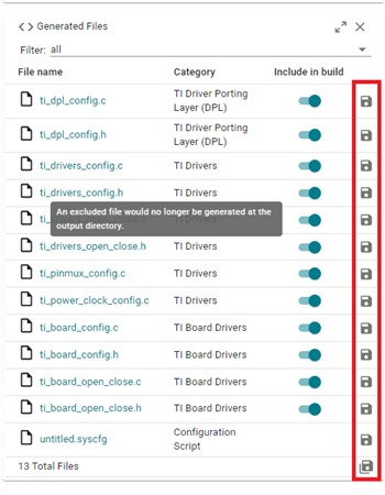

    1.How to replace “AM62x_pinmux_data.c” with “ti_pinmux_config.c”, it is read-only.
    You can save the file generated by Sysconfig tool and then you will be able to replace it.
    Please see the below screenshot.

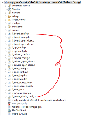

    For your use case, please follow the below steps:
    • Build the project without changing any files.
    • Once you have Sysconfig files generated, then look up the file named ti_pinmux_config.c and modify it using any text editor with the code you want to replace.
    • Next, copy the generated files and paste them into example directory as shown in the image below.
    • Set example.syscfg to be not included in the build and then build the project.
    Now you will be able to build the project without any errors.
    Please let me know if the above solution works.
    Tushar
