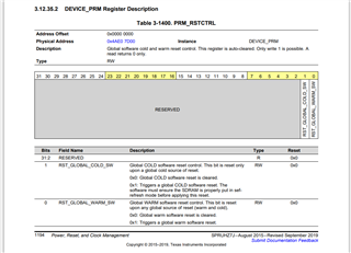

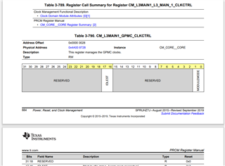

What is the address of the AM5708PRM_DEVICE_PRM_RSTCTRL register? There is also the address of the CM_PER_GPMC_CLKCTRL register
Which page are these two addresses in the manual? Can you give me a screenshot? Thank you

    Under AM570x and AM571x Sitara Processor Technical Reference Manual (Rev. J):
    • I see 32-bit PRM_RSTCTRL register from Power and Reset Management (PRM) of PRCM module described by Table 3-1400 on Page 1194 of 7686,
    • and another 32-bit CM_L3MAIN1_GPMC_CLKCTRL register from Clock Management (CM) of PRCM module described by Table 3-790 on Page 884 of 7686.
    Both of these have been provided under the section 3. Power, Reset, and Clock Management (PRCM) of the Technical Reference Manual (TRM) linked above.
    Please see if this helps in finding the registers related addressing information that you have asked about.
