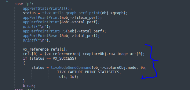

  • Hi Cherry,
    The csi_rx stats are integrated in the multi-cam demo app in the SDK
    If you press "p" in the interactive mode, you could see the stats from the csi_rx.
    This is just a control call to the csi-rx driver to extract the stats from the csi-rx driver.
    nikhil

    The relevant CSI-Rx stat information is not seen in these logs. Could you help share how to check it?

  • Hi Cherry,
    The highlighted part in the "p" prints the csi-rx stats. Could you please confirm if this is present in the code?

  • Hello Nikhil,
    Part "p" has not been modified.
    May I know which SDK version is customer on?
    ti-processor-sdk-rtos-j784s4-evm-08_06_00_14.

  • Hi Cherry,
    Do you mean they are not using the interactive mode to run the demo?
    As mentioned in the screenshot, if they are running in the interactive mode, upon pressing P, there should be csi-rx stats printed.
    Could you please confirm, if any hang is seen upon pressing "p"
    Nikhil

  • Hi Cherry,
    In the interactive mode, the part of the code in the screenshot should have printed the csi-rx stats.
    Could you please check why this has not been printed?

  • Hi Nikhil,
    May I know what does this print look like? So we could ask customer to double check it.
    May I know which SDK version is being used here?

  • Hi Cherry,
    The print looks something like below
    You would have to run ./vision_apps_init.sh before running the application to get the remote core logs.
    [MCU2_0]    182.902538 s:  Capture Status: Instance|0
