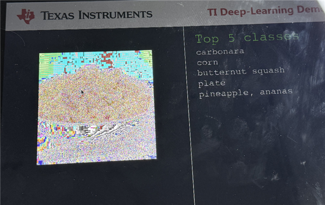

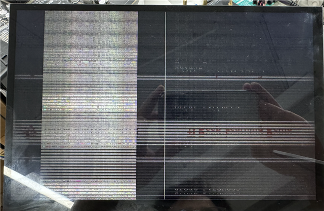

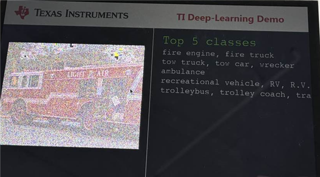

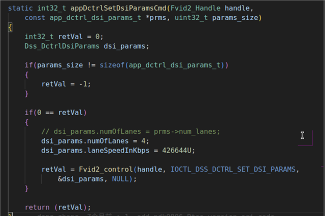

TDA4VM: DSI Display exception with 1280*800
Part Number: TDA4VM
My software version is:
  PDK-RTOS :processor-sdk-rtos-j721e-evm-08_06_00_12
  PDK-LINUX:processor-sdk-linux-08_06_00
My data flow is:
  TDA4VM-DSI->MAX96789->MAX96752->lvds->LCD

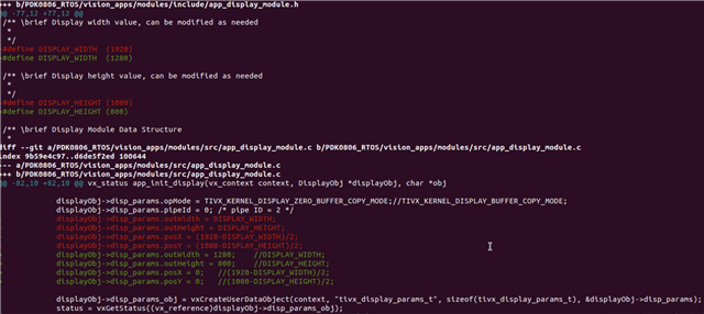

My code has been changed:
  1./PDK0806_RTOS/vision_apps/apps/dl_demos/app_tidl/app_common.h
  2.PDK0806_RTOS/vision_apps/apps/dl_demos/app_tidl/main.c
3./PDK0806_RTOS/vision_apps/modules/include/app_display_module.h
4.PDK0806_RTOS/vision_apps/modules/src/app_display_module.c
5./vision_apps/platform/j721e/rtos/common/app_cfg_mcu2_0.h
#undef ENABLE_CSI2TX
#undef ENABLE_DSS_EDP
#define ENABLE_DSS_DSI

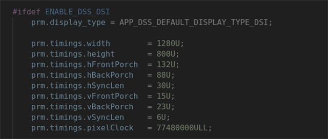

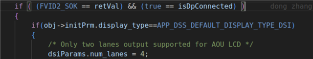

6.PDK0806_RTOS/vision_apps/platform/j721e/rtos/common/app_init.c
7.PDK0806_RTOS/vision_apps/utils/dss/src/app_dctrl.c
8.PDK0806_RTOS/vision_apps/utils/dss/src/app_dss_defaults.c

    Also are the pixel clock and lane speed setup correctly ? It shows only 7.5fps with display node taking around 58ms to display a frame..

  • Hi Brijesh,
    I modified the timing, and I can initially see the image, but the image is not clear.
    This is my latest config and TIDL output:
    dsi_params.numOfLanes = 4;
    dsi_params.laneSpeedInKbps = 464880U;
    1.Is this related to the color mode? How do I change the color mode in TIDL so that it displays properly?
    2. Why is my output only 7.5FPS? How should I adjust the TIDL_demo code to output 60FPS?
    please tell me thank you ,Looking forward to your reply
    Barry
  • Hi Brigesh,
    How should we solve this abnormal display problem? Please give us support. We look forward to your reply.
    Barry
  • Hi Barry,
    Are you sure that input images are correctly read in the demo? Because it looks like the only the input images are incorrect. TI logo and other text seems to be correct. So doubting on the input images.
    Brijesh
  • Hi Brigesh
    I did not change the input image of TIDL demo.
    I have not changed the input image under test_data. My modifications to the DSI output are listed above. We now suspect that the TIDL output does not match the screen color mode. The LVDS interface of this screen is VESA24. How should I change the color mode in TIDL? ?
    Please support us in solving this problem and look forward to your quick reply, thank you
    Barry
  • Hi Barry,
    Is there any other demo, which can be enabled here? I dont think this is related to VESA24 format, but it might be input color format issue. So wondering if any other demo is working fine. Lets say do you have input camera, then can you check single camera demo?
    Brijesh
  • Hi Brigesh,
    As with the modifications I provided above, we verified that only the output resolution of TIDL was modified, and other TIDL codes were not modified. Unfortunately, we do not have a camera and can only verify the demo output;
    In addition, I did a test. When I changed the photo under test_data/psdkra/app_tidl/ to a 16-bit color bmp image, the LCD display was consistent with the original image under test_data. It can be determined that the color mode caused this problem. Do we need to change the output format of TIDL? Can you tell me how to change it now?
    Looking forward to your reply.
    Barry

    Our LCD only supports RGB565 and RGB666. We are executing run_app_tidl.sh, and the output mode is DSI.
    How does TDA4 need to be modified to match the LCD color format output display? Can you help us reply? Thanks

  • Hi Brigesh,
    thanks for your reply.
    As you said, this limitation comes from the LCD screen. The LCD screen can only support RGB565/RGB666 input, so I need TDA4 DSI to output the RGB565 format to display correctly.
    Can you help us confirm the specific modification points for TDA4 to output DSI signals in RGB565 format? The output demo file I executed is run_app_tidl.sh;
    Looking forward for your reply, thank you

  • Hi Brigesh,
    thank you for your response.
    We also noticed and modified this; but the output display was disordered stripes when we executed run_app_tidl.sh; because the output demo we executed was run_app_tidl.sh, the configuration in this TIDL demo was still in RGB888 format;
    So can you tell us how to modify the output RGB565 format in TDA4 TIDL demo? (vision_apps/apps/dl_demos/app_tidl/main.c)
    Looking forward to your reply, thank you.
    Barry
