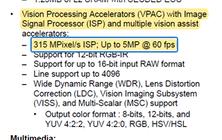

Follow data sheet description,  AM62A ISP support 315 MPixel/s, Up to 5MP @ 60 fps.

2. What's relationship between  315 MPixel/s & Up to 5MP @ 60 fps.?
I feel a little bit confuse,
TRMs say VAPC support 4096 pixels/line (8MP frame), but data sheet says it support 5MP.
What's the difference?
    5MP @ 60 fps = 300 MPixel/s which is 315 MPixel/s with a little head room.
    8MP can be supported but the frame rate will be limited to 300/8 = 37.5fps. The 5MP @ 60 fps use case is just one typical example.
