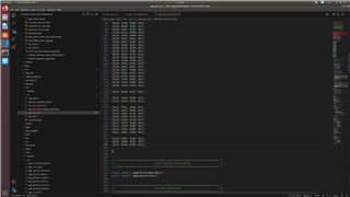

SDK version is ti-processor-sdk-rtos-j721s2-evm-08_06_01_03, may I ask what device is the IIC slave address 0x27 and 0x11 in the screenshot app_dss_soc.c file below?

We are am waiting for the confirmation from the DSS driver expert, But it mostly related to the serdes configuration and is need for only the J721E (TDA4VM).
The same serdes configuration can be found in the <PDK_path>/packages/drv/dss/examples/dss_display_test/dss_display_dsi_cfg.c file.

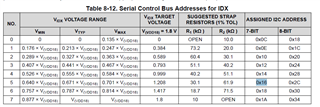

I still don't know what device is the IIC slave address 0x27 and 0x11 in the app_dss_soc.c file.Could you please help me continue to follow up on this issue.

The response from our expert is that these I2C lave addresses are related to the UB941 The only details we have is this.
This is the spec of UB941: https://www.ti.com/lit/ds/symlink/ds90ub941as-q1.pdf

As shown in the following figure, I only see the slave address the spec of UB941. Can you please ask TI's experts for clarification? what slave addresses 0x27, 0x11, and 0x12 are?

0x16: Address of ub941
0x11: Aliased address of remote deserializer, ub924
0x12: Aliased address of remote sensor device
0x27: IO Expander on the board.
