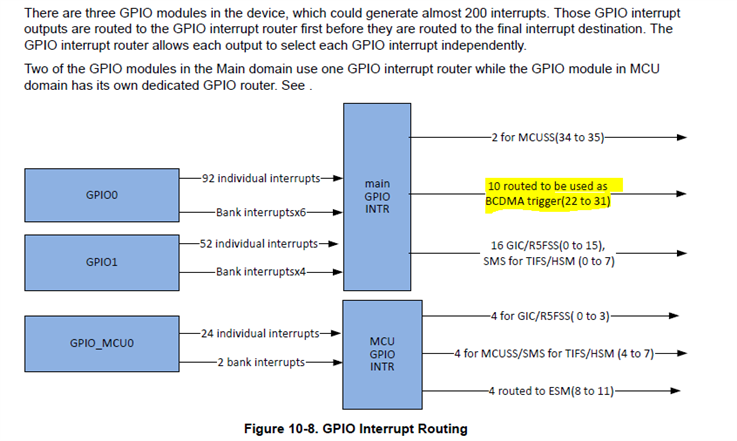

when am62a mcu use  12 mcu_gpios(such as mcu_gpio0_0 to mcu_gpio0_11) connect to 12 ak1 radars, the mcu_gpios config as input, and ak1 radar send  data.
we want use udma work as:  when one mcu_gpio recv a Rising edge or Falling edge,the udma auto read the GTC timer count and write to the memory which we config; from zhcab72.pdf gpio+udma cap pwm
1. How many udma we can use in the scene ?
2.  a udma can be trigged by any mcu_gpios(such as mcu_gpio0_0 to mcu_gpio0_11) ?
    What OS uses the MCU GPIO on AM62Ax, Linux or RTOS?
  • mcu use rtos

    Please look at the images below.
    There are main GPIOs and MCU GPIOs.
    If you see the yellow highlighted color, which triggers BCDMA through the main GPIO's and not with the MCU_GPIO's,.
    So, it is not possible to trigger BCMDA with MCU_GPIO's.

    Why you can't implement this method with simple GPIO IRQ Just enable bank interrupts for all mcu_gpio pins, then you may get an interrupt for any rising edge or falling edge, then read gtc time and put them in one memory, which is a simple use case and sending for smaller databytes; we don't need to use dma.
    Please look at the below image. By using CMP_EVENTS or GTC HW push, we can also auto-trigger BCMDA and see if this helps with your requirement.
    If you want to explore GTC +GPIO+ UDMA auto-triggers, just use the examples below. And try; in your use case, the source address would be the GTC Register address.

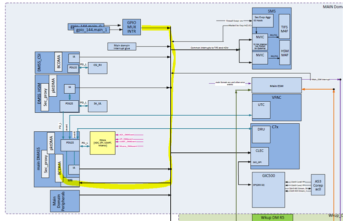

    one udma channel can be trigged by  multiple gpios  in different time periods.?
    Now, I understand your application, and you are using the below method.
    One GPIO pin should store the GTC time for every rising edge or falling edge. So, for every rising or falling edge, GTC time should be stored in one memory location, and the next GPIO pin should be used to transfer the data from the GTC source buffer to the destination buffer.
    You need the below approach for achieving your application.
    12 main GPIO pins and 12 UDMA channels are needed.
    One GPIO and one UDMA channel can be used to store GTC time, and another GPIO and UDMA channel can be used to transfer stored GTC time.
    But currently, in the AM62A device, we have 10 main GPIO router outputs that can be used to auto-trigger DMA, which is not possible with 12 radars, and we should go with 10 radars. Here, I never tried DMA for transferring 64-bit data since in this use case, the first channel should store the GTC time for every rising edge or falling edge.
    If you want to explore GPIO+ UDMA auto-triggers examples , please use the below link. Examples are available on AM64X and AM62X, and the same approach should be applicable to AM62A devices as well.
    https://github.com/TexasInstruments/Beyond-SDK
    2. one udma channel can be trigged by  multiple gpios  in different time periods.?
    For auto DMA trigger use cases during initializations, we need to allocate one dedicated channel for each UDMA +GPIO operation.
    In your use case, two radars work simultaneously, and you can use two dedicated channels in this case every time you enable and disable channels for each radar set.
    EX:
    Use 0 and 1 UDMA channel trigger data, and after operation is done for the first set of radar, next disable the channels of the first set of radar, and assign the same channels to the next set of radar, and so on. In this way, you can do it, but initializing  UDMA during running is not good.
    You don't need to bother about UDMA channels there are many channels are available  on AM62A devices .

  • if we need 10 radars work simultaneously,  we need 10 UDMA channels , the UDMA channels is enough ?
    Yes, you can connect 10 radars, and you need 10 dedicated UDMA channels since AM62A has 10 GPIO Router output's channels to trigger auto-DMA.
    -->One GPIO and one UDMA channel can be used to store GTC time, and another GPIO and UDMA channel can be used to transfer stored GTC time.
    all 12 GPIOs ' Rising edge or Falling edge GTC time need be save;
    Yes, all channels can store the GTC time for every rising and falling edge. You have to configure the GPIO trigger type for both the rising edge and the falling edge.
    Actually, as mentioned above, the AM62A has only 10 GPIO router outputs. So, you can connect 10 radars and 10 dedicated UDMA channels.
    gpio0_0-gpio0_11 can be dynamical ro route to 10 gpios which can trig dma ?, such as  :ues gpio0_0-gpio0_9  to trig 10 dma, then change gpio0_2-gpio0_11  to trig the10 dma ?
    I am explaining the above answer for 10 radars and not for 12 radars since we have only 10 GPIO router outputs, which can accommodate only 10 radars.
    EX: GPIO0 - > GPIO 9 pins used and 10 dedicated UDMA channels allocated for auto-trigger dma based on edge signals.
    Now, you wanted to change triggers DMA from different GPIO's, like GPIO2 > GPIO11, with the same 10UDMA channels.
    Yes, it is possible. In the above use case, you have reinitialized the UDMA channel allocation for the corresponding GPIO pins.

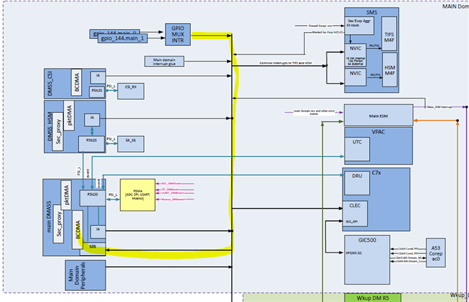

  • Hi Swargam,
    Is it possible to use ecap to receive the signal and trigger UDMA interrupt? If this is possible, then we can use GPtimer and EPWM together to get 12 USS.
  • Hello Adam Hua,
    I have looked at AM62A SOC TRM and this is not possible, and there are no UDAM triggers from the ECAP Module. Please look at the below images.
    So, UDMA triggers are not possible from ECAP modules.
