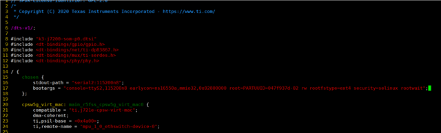

Dear TI,
I have a problem with DeviceTree Source.
I add selinux in kernel.
Bootargs are set in the dts/ti/k3-j7200-common-proc-board.dts file, "security=selinux" is added.

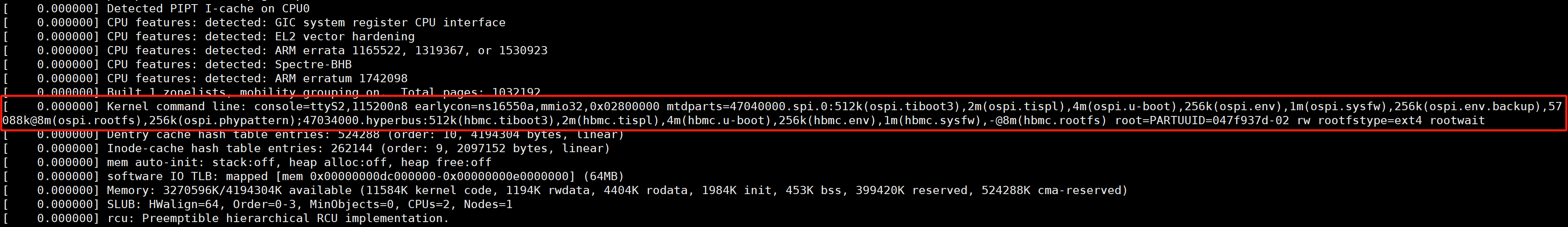

After startup, there is no "security=selinux" in the Kernel command line. selinux is not enabled.
    We do not support selinux option by default. Is adding only the bootargs sufficient? don't we need to enable additional configs to enable in kernel?

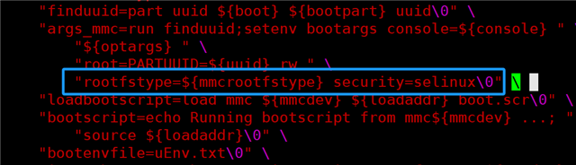

    Can you add in the following file:
    File: $PSDK_Linux/board-support/u-boot-2023.04*/include/environment/ti/mmc.env
    Original Variable: args_mmc=run finduuid;setenv bootargs console=${console}
            ${optargs}
            root=PARTUUID=${uuid} rw
            rootfstype=${mmcrootfstype}
    Once you add: args_mmc=run finduuid;setenv bootargs console=${console}
            ${optargs}
            rootfstype=${mmcrootfstype}security=selinux
    Try and let me know if this helps.
    Keerthy
  • There is no mmc.env file in our SDK, we modified mmc.h.
    It works!
