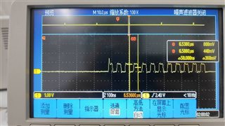

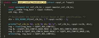

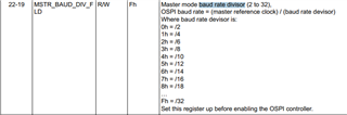

In SDK8.6, I modified the ospi clock to 166MHZ in dts, but when I conducted flash read and write tests, I measured the ospi clock frequency and found that it was only 20MHZ, and the read and write speed was also very low. Please help to investigate the reason.
