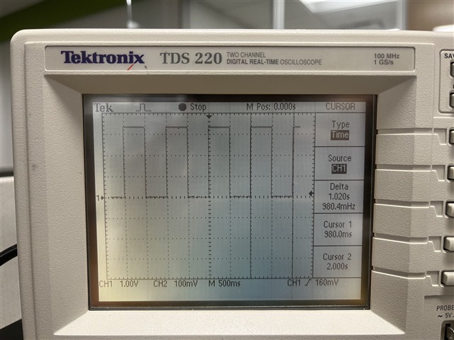

I'm trying to get 1-PPS out of SK-AM64B.  I followed the recommendation from this thread, but I wasn't able to get 1-PPS out of J3 (on SK-AM64B board this is SYNC0_OUT_TP --> my understanding it's a typo in schematic to call it SYNC1_OUT_TP, SYNC0_OUT_TP is correct).
https://e2e.ti.com/support/processors-group/processors/f/processors-forum/1253565/am6442-gpevm-how-to-check-1-pps
This is what I updated to... except I also tried PIN_OUTPUT, seemed like it should be an output.  Neither allowed me to see 1-PPS on J3.
        main_ecap0_pins_default: main-ecap0-pins-default {
                pinctrl-single,pins = <
                        AM64X_IOPAD(0x0270, PIN_INPUT, 1) /* (D18) ECAP0_IN_APWM_OUT -> SYNC0_OUT */
Although I don't think I've got this.... is this in the #include <dt-bindings/net/ti-dp83867.h>    --> Don't have my linux box up to check.
        cpsw_cpts_pps: cpsw-cpts-pps {
                        /* pps [cpts genf1] in22 -> out37 [cpts hw8_push] */
                        TS_OFFSET(37, 22)
                        /* pps [cpts genf1] in22 -> out26 [SYNC1_OUT pin] */
                        TS_OFFSET(26, 22)
So I'm wanting to test the accuracy of aligning 1-PPS with PTP on some SK-AM64B boards, so need to get this working.
Thanks for your assistance.  Attached is the DTS I'm working with.
73,
Timothy

  • Hi Timothy,
    The key step you are missing is to run the testptp program on the board before measuring on the J3 header. This testptp program should exist by default on the default SDK but it's a little hidden. I've listed down the steps that allowed me to generate PPS signal on the J3 header.
    Just reiterating the steps I have sent in my email along with some additional background information.
    1. Flash an SD card with the SDK 8.06.00 RT tisdk-default-image-am64xx-evm.wic.xz
      1. This is because the testptp program exists by default on this SDK but not on the latest 9.0 SDK (we filed a bug on this issue)
      2. Also, I used the RT SDK image but I suspect the non-RT 8.06 SDK should also work
    2. Install ti-processor-sdk-linux-rt-am64xx-evm-08.06.00.42-Linux-x86-Install.bin
      1. This is to do dts modifications and to build the dtb files
    3. Make the following modifications on the k3-am642-sk.dts file (I think you are very close on this step)
    &timesync_router {
    	pinctrl-names = "default";
    	pinctrl-0 = <&mcu_cpts_pps>;
    	/* Example of the timesync routing */
    	mcu_cpts_pps: mcu-cpts-pps {
    				TS_OFFSET(37, 22)
    				/* pps [cpts genf1] in22 -> out24 [SYNC1_OUT pin (25)-> SYNC0_OUT pin (24)] */
    				TS_OFFSET(24, 22)
    1. Build the k3-am642-sk.dts to generate the k3-am642-sk.dtb file (I've attached this for your convenience - keep in mind this was built with the 8.06 RT SDK)
    2. Copy the k3-am642-sk.dtb file into <SD card path>/root/boot
    3. Plug the SD card into the AM64B SK board and power on the board
    4. Type the following in the terminal of the AM64B SK board
    root@am64xx-evm:~# /usr/bin/kselftests/ptp/testptp -d /dev/ptp0 -P 1
    1. Probe the J3 header with an O-scope
    I was able to capture the following signal on an O-scope:
    https://e2e.ti.com/cfs-file/__key/communityserver-discussions-components-files/791/3005.k3_2D00_am642_2D00_sk.dtb
    Please let me know if this works for you.
    Daolin
  • Thanks, I now have 1-PPS!
    73,
    Timothy
