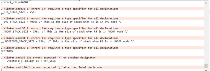

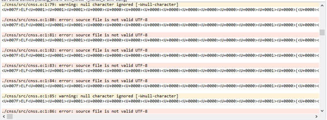

We encountered some linker errors after we added "-x c++" option in .projectspec file. We want to run an example lwip-enet project as c++. Although we changed the makefle of the project according to helloworld-cpp example, it raised some errors about std libs like iostream. After that we added "-x c++" option to the projectspec then we got some new errors that doesn't even related with our changes. I just want to learn about what does "-x c++" option stand for in projectspec? Also, what are some concerns that I should to take a look while migrating a c project to c++?
You can see some errors at the below:

  • Hello Mirza,
    I have migrated this project "examples/networking/lwip/enet_cpsw_udpclient" to C++ and I am able to build it successfully without any errors.
    I am attaching the sample project's .zip file below.
    Please find the project.zip.
    You can make changes to this project according to your use case. The above is just a sample project that uses multiple .cpp and .c files as a single project .
    To know about the -x option to control input file interpretation, please refer controlling-source-file-interpretation-with-the-x-option.
    Please let me know if the above solution works for you.

  • Hi Tushar,
    Firstly, thank you for response. I have a question about "linker.cmd" file. There is no "Sections needed for C++ projects " part in linker.cmd file of your example. Why you didn't implement this section?
  • Hi Mirza,
    Thank you for your response.
    Yes, I haven't done the linker changes as the main query was about to build the project as a C++ project which was building fine. If a particular section is not specified  you will see a warning at compile time about the unallocated section similar to below one. But you will be able to build the project.
    Meanwhile I am providing the linker.cmd changes required.
    Please find the below linker changes that has the section for C++ exception handling.

        /* Sections needed for C++ projects */
        GROUP {
            .ARM.exidx:  {} palign(8)   /* Needed for C++ exception handling */
            .init_array: {} palign(8)   /* Contains function pointers called before main */
            .fini_array: {} palign(8)   /* Contains function pointers called after main */
        } > DDR
