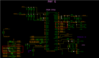

      we are developing a custom platform with a main TDA4 SoC.
Processor SDK version: ti-processor-sdk-linux-j7-evm-08_06_01_02
On our platform we have connected several Marvell 88E1512 Ethernet PHY to Ethernet switch CPSW0 on main domain.
We encountered the following problem:CPSW0 eth1 cannot link up.
CPSW0:serdes4_sgmii_port5--->eth1
This is the hardware schematic:
dts:

Now, we only have TD40P, TD40N, RD40P, and RD40N cables connected to our hardware for 100Mbps use. Here is the situation with my eth1.
Please help me investigate what caused it? Thank you.
