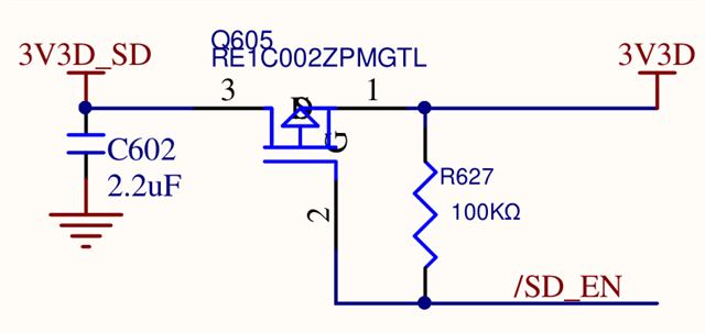

Hi TI Team,
We are going to use AM625 SoC in our custom device, ti-processor-sdk-linux-am62xx-evm-09.00.00.03 as SDK.
We modified k3-am625-sk.dts with reference to mmc1 and used the mmc2 ports to connect to sdmmc, but a problem occurred that no card present.
=> mmc list
mmc@fa20000: 2
=> mmc dev 2
MMC: no card present
Specifically k3-am625-sk.dts is modified as follows

Related Schematic Diagrams as follows,(Q605)RE1C002ZPMGTL is P-channel mosfet.
Whether or not these changes are wrong,or continue to change the devicetree and deconfig?
Thanks in advance.

  • Hello Long,
    Do we have MMC2_SDCD pin connected on your board?
    e.g. on SK-AM62 board (www.ti.com/.../SK-AM62B)
    - Search for "MMC1_SDCD" in SK-AM62 schematics on how "MMC1_SDCD" is connected.
    - "MMC1_SDCD" configuration in MMC1 node for SK-AM62 board
    https://git.ti.com/cgit/ti-u-boot/ti-u-boot/tree/arch/arm/dts/k3-am625-sk.dts?h=09.01.00.008#n264
    https://git.ti.com/cgit/ti-u-boot/ti-u-boot/tree/arch/arm/dts/k3-am625-sk.dts?h=09.01.00.008#n449
    Some options for you:
    1. Connect/configure "MMC2_SDCD" for your board as for "MMC1_SDCD" on TI SK-AM62
    2. Alternatively, try adding "broken-cd" to MMC2 DT node
    https://www.kernel.org/doc/Documentation/devicetree/bindings/mmc/mmc-controller.yaml
    -Hong
  • Hello Hong,
    I check and find that there is no "MMC2_SDCD" connected to our board, I'll connect  "MMC2_SDCD" and test  again.
