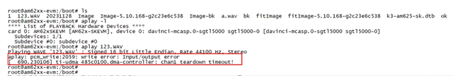

Hi Team,
When use apaly command, ti-dma 485c0100.dma-controller: chan1 teardown time.
https://e2e.ti.com/cfs-file/__key/communityserver-discussions-components-files/791/7776.k3_2D00_am62x_2D00_sk_2D00_common.dtsi
In this e2e:PROCESSOR-SDK-AM62X: Audio playback DMA teardown complete not seen after DMA teardown requested - Processors forum - Processors - TI E2E support forums Said it will be fixed by  next SDK release seven months ago. Now I want to know whether it has been fixed? Where to find the patches for SDK8.6?
Zane
  • Hi Zane,
    Is the customer still on 8.6 Release, Can they move to the latest 9.0 release or 9.1 release scheduled to release this month?
    Also, I am guessing the customer is able to play and sees this error at the end of playback before exiting, correct?
    Suren
  • Hi Suren,
    Does it fixed in SDK9.0?

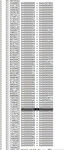

    It cant playback. Customer has tested the output of I2S, but there is no output signal. After running a moment, it will display udma error.
    Zane
  • Hi Suren,
    Here is dts and driver code. Thanks for your help!
    https://e2e.ti.com/cfs-file/__key/communityserver-discussions-components-files/791/7607.k3_2D00_am62x_2D00_sk_2D00_common.dtsi

  • Hi Zane,
    Can you ask the customer to check if they are seeing the BCLK/LRCLK correctly on the McASP pins?
    Suren
  • Hi Suren,
    CLK signal is correct. But dont have data signal.
    I think this problem related with the below E2E
    AM625: Interrupt storm from DMA controller, possibly related to McASP - Processors forum - Processors - TI E2E support forums
    Is this E2E has any update?
    Zane

  • Hey Zane,
    How are they providing the MCLK to the codec?
    Can you ask customer to share the McASP status registers dump. This will also help them analyze the error flags in these registers to understand what might be going wrong.
    Suren
  • Hi, Suren
    Here is the McASP registers dump:
    Another question:
    When testing to play sound, after calling mcasp_start_tx() to enable irq, the irq_handler() function was not executed. What might cause this?
    Zane
  • Zane,
    Happy New year. Apologies for the delay.
    Can you confirm they are seeing the audioplayback issue on EVM or custom board? If its custom board, who is providing the MCLK and what's the Bitclock and Frame sync?
    In the meantime, I am checking internally on the IRQ handler function. Will respond back as soon as I have an update.
    Suren
  • Hi Suren,
    Thanks for your support! A stupid mistake, the clock line is connected backwards by customers.
    Zane
