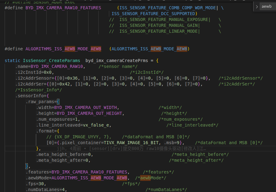

Customer enables AEWB  and realizes auto exposure, auto white balance in below code, but it doesn't work, the camera can't auto exposure. How to modify code?
Below is the log after booting. aewb_cfg.ae_mode = 0 awb_mode = 0 means auto exposure and auto white-balance.
