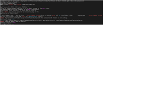

Customer found the playbin is failed while using GST 1.0, the error log is the below.
plz help.
Thanks.
BR Rio
root@am57xx-evm:~# gst-launch-1.0 playbin uri=file:///usr/share/ti/video/HistoryOfTI-480p.m2v audio-sink=alsasink video-sink=kmssink scale=true
Setting pipeline to PAUSED ...
ERROR: Pipeline doesn't want to pause.
ERROR: from element /GstAlsaSink:alsasink0: Could not open audio device for playback.
Additional debug info:
../../../gst-plugins-base-1.2.3/ext/alsa/gstalsasink.c(851): gst_alsasink_open (): /GstAlsaSink:alsasink0:
Playback open error on device 'default': No such file or directory
Setting pipeline to NULL ...
Freeing pipeline ...

  • Hi Fabiana:
    Customer tested many cases in the attached file.
    Please review and let us know how to fix  those errors inside the attached.
    Thanks.
    ../../../git/sys/kms/gstkmssink.c(90): gst_kms_sink_calculate_aspect_ratio (): /GstPlayBin:playbin0/GstPlaySink:playsink/GstBin:vbin/GstKMSSink:kmssink0:
    Error calculating the output display ratio of the video.
    Execution ended after 0:00:00.003872117
    Setting pipeline to READY ...
    root@am57xx-evm:~# gst-launch-1.0 filesrc location=/usr/share/ti/video/HistoryOfTI-480p.264 video-sink=kmssink scale=true gst-debug=3 -v
    WARNING: erroneous pipeline: no property "video-sink" in element "filesrc0"
    root@am57xx-evm:~# gst-launch-1.0 filesrc location=/usr/share/ti/video/HistoryOfTI-480p.264 ! qtdemux ! h264parse ! ducatih264decvpe ! kmssink
    MmRpc_create: Error: open failed, name=/dev/rpmsg-dce
    ../git/libdce.c:198:    dce_ipc_init     Error: ERROR: Failed eError == DCE_EOK error val -4../git/libdce.c:276:        Engine_open      Error: ERROR: Failed dce_ipc_init(coreIdx) == DCE_EOK error val -4Setting pipeline to NULL ...
    root@am57xx-evm:~# gst-launch-1.0 playbin uri=file:///usr/share/ti/video/TearOfSteel-AV-Short-720x406.mp4 video-sink=kmssink scale=true gst-debug=3 -v
    /GstPlayBin:playbin0/GstURIDecodeBin:uridecodebin0: ring-buffer-max-size = 0
    /GstPlayBin:playbin0/GstURIDecodeBin:uridecodebin0: buffer-size = -1
    /GstPlayBin:playbin0/GstURIDecodeBin:uridecodebin0: buffer-duration = -1
    /GstPlayBin:playbin0/GstURIDecodeBin:uridecodebin0: use-buffering = false
    /GstPlayBin:playbin0/GstURIDecodeBin:uridecodebin0: download = false
    /GstPlayBin:playbin0/GstURIDecodeBin:uridecodebin0: uri = file:///usr/share/ti/video/TearOfSteel-AV-Short-720x406.mp4
    /GstPlayBin:playbin0/GstURIDecodeBin:uridecodebin0: connection-speed = 0
    /GstPlayBin:playbin0/GstURIDecodeBin:uridecodebin0: source = "\(GstFileSrc\)\ source"
    Pipeline is PREROLLING ...
    /GstPlayBin:playbin0/GstURIDecodeBin:uridecodebin0/GstDecodeBin:decodebin0/GstTypeFindElement:typefind.GstPad:src: caps = video/quicktime, variant=(string)iso
    /GstPlayBin:playbin0/GstURIDecodeBin:uridecodebin0/GstDecodeBin:decodebin0/GstTypeFindElement:typefind.GstPad:src: caps = NULL
    /GstPlayBin:playbin0/GstURIDecodeBin:uridecodebin0/GstDecodeBin:decodebin0/GstMultiQueue:multiqueue0: max-size-buffers = 5
    /GstPlayBin:playbin0/GstURIDecodeBin:uridecodebin0/GstDecodeBin:decodebin0/GstMultiQueue:multiqueue0: max-size-time = 0
    /GstPlayBin:playbin0/GstURIDecodeBin:uridecodebin0/GstDecodeBin:decodebin0/GstMultiQueue:multiqueue0: max-size-bytes = 2097152
    /GstPlayBin:playbin0/GstURIDecodeBin:uridecodebin0/GstDecodeBin:decodebin0/GstMultiQueue:multiqueue0.GstPad:sink_0: caps = video/mpeg, mpegversion=(int)4, systemstream=(boolean)false, profile=(string)simple, level=(string)1, codec_data=(buffer)000001b001000001b58913000001000000012000c48d8800c5168432d443000001b24c61766335352e36362e313030, width=(int)720, height=(int)406, framerate=(fraction)24/1, pixel-aspect-ratio=(fraction)1/1
    /GstPlayBin:playbin0/GstURIDecodeBin:uridecodebin0/GstDecodeBin:decodebin0/GstMultiQueue:multiqueue0.GstPad:sink_1: caps = audio/mpeg, mpegversion=(int)4, framed=(boolean)true, stream-format=(string)raw, level=(string)2, base-profile=(string)lc, profile=(string)lc, codec_data=(buffer)1210, rate=(int)44100, channels=(int)2
    (gst-launch-1.0:2645): GStreamer-CRITICAL **:
    Trying to dispose element vpe, but it is in READY instead of the NULL state.
    You need to explicitly set elements to the NULL state before
    dropping the final reference, to allow them to clean up.
    This problem may also be caused by a refcounting bug in the
    application or some element.
    ../git/libdce.c:198:    dce_ipc_init     Error: ERROR: Failed eError == DCE_EOK error val -4../git/libdce.c:276:        Engine_open      Error: ERROR: Failed dce_ipc_init(coreIdx) == DCE_EOK error val -4/GstPlayBin:playbin0/GstURIDecodeBin:uridecodebin0/GstDecodeBin:decodebin0/GstMpeg4VParse:mpeg4vparse0.GstPad:src: caps = video/mpeg, mpegversion=(int)4, systemstream=(boolean)false, profile=(string)simple, level=(string)1, codec_data=(buffer)000001b001000001b58913000001000000012000c48d8800c5168432d443000001b24c61766335352e36362e313030, width=(int)720, height=(int)406, framerate=(fraction)24/1, pixel-aspect-ratio=(fraction)1/1, parsed=(boolean)true
    /GstPlayBin:playbin0/GstURIDecodeBin:uridecodebin0/GstDecodeBin:decodebin0/avdec_mpeg4:avdec_mpeg4-0.GstPad:sink: caps = video/mpeg, mpegversion=(int)4, systemstream=(boolean)false, profile=(string)simple, level=(string)1, codec_data=(buffer)000001b001000001b58913000001000000012000c48d8800c5168432d443000001b24c61766335352e36362e313030, width=(int)720, height=(int)406, framerate=(fraction)24/1, pixel-aspect-ratio=(fraction)1/1, parsed=(boolean)true
    Redistribute latency...
    /GstPlayBin:playbin0/GstURIDecodeBin:uridecodebin0/GstDecodeBin:decodebin0/GstAacParse:aacparse0.GstPad:src: caps = audio/mpeg, mpegversion=(int)4, framed=(boolean)true, stream-format=(string)raw, level=(string)2, base-profile=(string)lc, profile=(string)lc, codec_data=(buffer)1210, rate=(int)44100, channels=(int)2
    /GstPlayBin:playbin0/GstURIDecodeBin:uridecodebin0/GstDecodeBin:decodebin0/GstFaad:faad0.GstPad:sink: caps = audio/mpeg, mpegversion=(int)4, framed=(boolean)true, stream-format=(string)raw, level=(string)2, base-profile=(string)lc, profile=(string)lc, codec_data=(buffer)1210, rate=(int)44100, channels=(int)2
    /GstPlayBin:playbin0/GstURIDecodeBin:uridecodebin0/GstDecodeBin:decodebin0/GstAacParse:aacparse0.GstPad:sink: caps = audio/mpeg, mpegversion=(int)4, framed=(boolean)true, stream-format=(string)raw, level=(string)2, base-profile=(string)lc, profile=(string)lc, codec_data=(buffer)1210, rate=(int)44100, channels=(int)2
    /GstPlayBin:playbin0/GstURIDecodeBin:uridecodebin0/GstDecodeBin:decodebin0/GstFaad:faad0.GstPad:src: caps = audio/x-raw, format=(string)S16LE, layout=(string)interleaved, rate=(int)44100, channels=(int)2, channel-mask=(bitmask)0x0000000000000003
    /GstPlayBin:playbin0/GstURIDecodeBin:uridecodebin0/GstDecodeBin:decodebin0/avdec_mpeg4:avdec_mpeg4-0.GstPad:src: caps = video/x-raw, format=(string)I420, width=(int)720, height=(int)406, pixel-aspect-ratio=(fraction)1/1, interlace-mode=(string)progressive, colorimetry=(string)bt601, framerate=(fraction)24/1
    /GstPlayBin:playbin0/GstInputSelector:inputselector0.GstSelectorPad:sink_0: always-ok = false
    /GstPlayBin:playbin0/GstInputSelector:inputselector1.GstSelectorPad:sink_0: always-ok = false
    /GstPlayBin:playbin0/GstInputSelector:inputselector0.GstSelectorPad:sink_0: active = true
    /GstPlayBin:playbin0/GstInputSelector:inputselector0: active-pad = "\(GstSelectorPad\)\ sink_0"
    /GstPlayBin:playbin0/GstInputSelector:inputselector1.GstSelectorPad:sink_0: active = true
    /GstPlayBin:playbin0/GstInputSelector:inputselector1: active-pad = "\(GstSelectorPad\)\ sink_0"
    ERROR: from element /GstPlayBin:playbin0/GstPlaySink:playsink: The autoaudiosink element is not working.
    ../../../gst-plugins-base-1.2.3/gst/playback/gstplaysink.c(2687): gen_audio_chain (): /GstPlayBin:playbin0/GstPlaySink:playsink
    ERROR: pipeline doesn't want to preroll.
    /GstPlayBin:playbin0/GstInputSelector:inputselector0.GstPad:src: caps = video/x-raw, format=(string)I420, width=(int)720, height=(int)406, pixel-aspect-ratio=(fraction)1/1, interlace-mode=(string)progressive, colorimetry=(string)bt601, framerate=(fraction)24/1
    /GstPlayBin:playbin0/GstInputSelector:inputselector1.GstPad:src: caps = audio/x-raw, format=(string)S16LE, layout=(string)interleaved, rate=(int)44100, channels=(int)2, channel-mask=(bitmask)0x0000000000000003
    /GstPlayBin:playbin0/GstPlaySink:playsink.GstGhostPad:audio_sink.GstProxyPad:proxypad8: caps = audio/x-raw, format=(string)S16LE, layout=(string)interleaved, rate=(int)44100, channels=(int)2, channel-mask=(bitmask)0x0000000000000003
    /GstPlayBin:playbin0/GstPlaySink:playsink/GstTee:audiotee.GstPad:sink: caps = audio/x-raw, format=(string)S16LE, layout=(string)interleaved, rate=(int)44100, channels=(int)2, channel-mask=(bitmask)0x0000000000000003
    /GstPlayBin:playbin0/GstPlaySink:playsink.GstGhostPad:audio_sink: caps = audio/x-raw, format=(string)S16LE, layout=(string)interleaved, rate=(int)44100, channels=(int)2, channel-mask=(bitmask)0x0000000000000003
    /GstPlayBin:playbin0/GstInputSelector:inputselector1.GstSelectorPad:sink_0: caps = audio/x-raw, format=(string)S16LE, layout=(string)interleaved, rate=(int)44100, channels=(int)2, channel-mask=(bitmask)0x0000000000000003
    /GstPlayBin:playbin0/GstURIDecodeBin:uridecodebin0.GstGhostPad:src_1.GstProxyPad:proxypad7: caps = audio/x-raw, format=(string)S16LE, layout=(string)interleaved, rate=(int)44100, channels=(int)2, channel-mask=(bitmask)0x0000000000000003
    /GstPlayBin:playbin0/GstInputSelector:inputselector1.GstSelectorPad:sink_0: tags = "taglist\,\ encoder\=\(string\)Lavf55.42.101\,\ container-format\=\(string\)\"ISO\\\ MP4/M4A\"\;"
    /GstPlayBin:playbin0/GstInputSelector:inputselector1.GstSelectorPad:sink_0: tags = "taglist\,\ encoder\=\(string\)Lavf55.42.101\,\ container-format\=\(string\)\"ISO\\\ MP4/M4A\"\,\ audio-codec\=\(string\)\"MPEG-4\\\ AAC\\\ audio\"\,\ maximum-bitrate\=\(uint\)128044\,\ bitrate\=\(uint\)127823\,\ language-code\=\(string\)en\;"
    /GstPlayBin:playbin0/GstPlaySink:playsink/GstTee:audiotee.GstPad:sink: caps = NULL
    /GstPlayBin:playbin0/GstPlaySink:playsink.GstGhostPad:audio_sink.GstProxyPad:proxypad8: caps = NULL
    /GstPlayBin:playbin0/GstPlaySink:playsink.GstGhostPad:audio_sink: caps = NULL
    /GstPlayBin:playbin0/GstInputSelector:inputselector0.GstSelectorPad:sink_0: caps = video/x-raw, format=(string)I420, width=(int)720, height=(int)406, pixel-aspect-ratio=(fraction)1/1, interlace-mode=(string)progressive, colorimetry=(string)bt601, framerate=(fraction)24/1
    /GstPlayBin:playbin0/GstURIDecodeBin:uridecodebin0.GstGhostPad:src_0.GstProxyPad:proxypad6: caps = video/x-raw, format=(string)I420, width=(int)720, height=(int)406, pixel-aspect-ratio=(fraction)1/1, interlace-mode=(string)progressive, colorimetry=(string)bt601, framerate=(fraction)24/1
    /GstPlayBin:playbin0/GstURIDecodeBin:uridecodebin0/GstDecodeBin:decodebin0.GstDecodePad:src_0.GstProxyPad:proxypad2: caps = video/x-raw, format=(string)I420, width=(int)720, height=(int)406, pixel-aspect-ratio=(fraction)1/1, interlace-mode=(string)progressive, colorimetry=(string)bt601, framerate=(fraction)24/1
    /GstPlayBin:playbin0/GstInputSelector:inputselector1.GstPad:src: caps = NULL
    /GstPlayBin:playbin0/GstInputSelector:inputselector1.GstSelectorPad:sink_0: caps = NULL
    /GstPlayBin:playbin0/GstInputSelector:inputselector0.GstPad:src: caps = NULL
    /GstPlayBin:playbin0/GstInputSelector:inputselector0.GstSelectorPad:sink_0: caps = NULL
    /GstPlayBin:playbin0/GstURIDecodeBin:uridecodebin0.GstGhostPad:src_0.GstProxyPad:proxypad6: caps = NULL
    /GstPlayBin:playbin0/GstURIDecodeBin:uridecodebin0.GstGhostPad:src_0: caps = NULL
    /GstPlayBin:playbin0/GstURIDecodeBin:uridecodebin0.GstGhostPad:src_1.GstProxyPad:proxypad7: caps = NULL
    /GstPlayBin:playbin0/GstURIDecodeBin:uridecodebin0.GstGhostPad:src_1: caps = NULL
    /GstPlayBin:playbin0/GstURIDecodeBin:uridecodebin0/GstDecodeBin:decodebin0.GstDecodePad:src_0.GstProxyPad:proxypad2: caps = NULL
    /GstPlayBin:playbin0/GstURIDecodeBin:uridecodebin0/GstDecodeBin:decodebin0.GstDecodePad:src_0: caps = NULL
    /GstPlayBin:playbin0/GstURIDecodeBin:uridecodebin0/GstDecodeBin:decodebin0.GstDecodePad:src_1.GstProxyPad:proxypad3: caps = NULL
    /GstPlayBin:playbin0/GstURIDecodeBin:uridecodebin0/GstDecodeBin:decodebin0.GstDecodePad:src_1: caps = NULL
    /GstPlayBin:playbin0/GstURIDecodeBin:uridecodebin0/GstDecodeBin:decodebin0/GstFaad:faad0.GstPad:src: caps = NULL
    /GstPlayBin:playbin0/GstURIDecodeBin:uridecodebin0/GstDecodeBin:decodebin0/GstFaad:faad0.GstPad:sink: caps = NULL
    /GstPlayBin:playbin0/GstURIDecodeBin:uridecodebin0/GstDecodeBin:decodebin0/GstAacParse:aacparse0.GstPad:src: caps = NULL
    /GstPlayBin:playbin0/GstURIDecodeBin:uridecodebin0/GstDecodeBin:decodebin0/GstAacParse:aacparse0.GstPad:sink: caps = NULL
    /GstPlayBin:playbin0/GstURIDecodeBin:uridecodebin0/GstDecodeBin:decodebin0/avdec_mpeg4:avdec_mpeg4-0.GstPad:src: caps = NULL
    /GstPlayBin:playbin0/GstURIDecodeBin:uridecodebin0/GstDecodeBin:decodebin0/avdec_mpeg4:avdec_mpeg4-0.GstPad:sink: caps = NULL
    /GstPlayBin:playbin0/GstURIDecodeBin:uridecodebin0/GstDecodeBin:decodebin0/GstMpeg4VParse:mpeg4vparse0.GstPad:src: caps = NULL
    /GstPlayBin:playbin0/GstURIDecodeBin:uridecodebin0/GstDecodeBin:decodebin0/GstMpeg4VParse:mpeg4vparse0.GstPad:sink: caps = NULL
    /GstPlayBin:playbin0/GstURIDecodeBin:uridecodebin0/GstDecodeBin:decodebin0/GstMultiQueue:multiqueue0.GstPad:src_0: caps = NULL
    /GstPlayBin:playbin0/GstURIDecodeBin:uridecodebin0/GstDecodeBin:decodebin0/GstMultiQueue:multiqueue0.GstPad:src_1: caps = NULL
    /GstPlayBin:playbin0/GstURIDecodeBin:uridecodebin0/GstDecodeBin:decodebin0/GstMultiQueue:multiqueue0.GstPad:sink_0: caps = NULL
    /GstPlayBin:playbin0/GstURIDecodeBin:uridecodebin0/GstDecodeBin:decodebin0/GstMultiQueue:multiqueue0.GstPad:sink_1: caps = NULL
    /GstPlayBin:playbin0/GstURIDecodeBin:uridecodebin0/GstDecodeBin:decodebin0/GstQTDemux:qtdemux0.GstPad:video_0: caps = NULL
    /GstPlayBin:playbin0/GstURIDecodeBin:uridecodebin0/GstDecodeBin:decodebin0/GstQTDemux:qtdemux0.GstPad:audio_0: caps = NULL
    root@am57xx-evm:~# gst-launch-1.0 filesrc location=/usr/share/ti/video/TearOfSteel-AV-Short-720x406.mp4 video-sink=kmssink scale=true gst-debug=3 -v
    root@am57xx-evm:~# gst-launch-1.0 filesrc location=/usr/share/ti/video/TearOfSteel-AV-Short-720x406.mp4 ! qtdemux ! h264parse ! ducatih264decvpe ! kmssink
