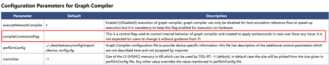

      I want to export the model via the TIDL PC Importer tool to get the board-side inference time for the PC simulation, so I use the compileConstraintsFlag parameter.
      I found a description of the compileConstraintsFlag parameter in the documentation released by TI.
     So, how do I configure the compileConstraintsFlag parameter when exporting the model?
Thank you

    Can you teach me how to use the compileConstraintsFlag parameter? I would like to know how to configure it.

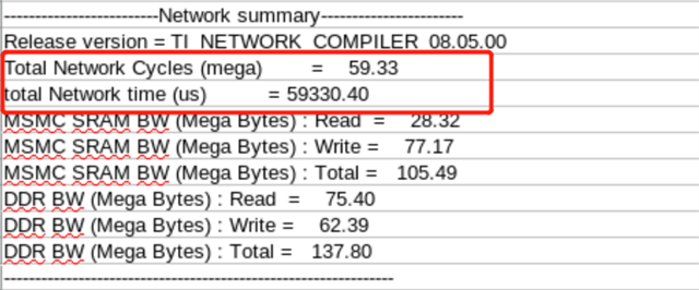

    In PC emulation mode, I configured the parameter compileConstraintsFlag=83886080 and used the TIDL Importer Tool to export the model. After I successfully exported, I was able to find a .csv file about the DSP in the output document, which recorded the time spent for model inference. However, the network time of this .csv file deviates greatly from the actual deployment time of the model.
    So, how do I configure the compileConstraintsFlag parameter to reduce the bias?
    (PC emulation total Network times(us) = 59330.40    Board deploy total natwork times(us) = 235321.60)
  • The host emulation benchmarks are prone to mem latency / register latency reads/write delays, this number can be taken as reference but not actual reading.
    We recommend our customers to perform benchmarking of models on EVM for final benchmark.
