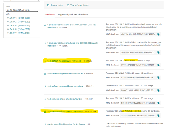

With SDK 9.0, are you trying to use yocto image or debian image?
Please have a look at the image below.
Vaibhav
